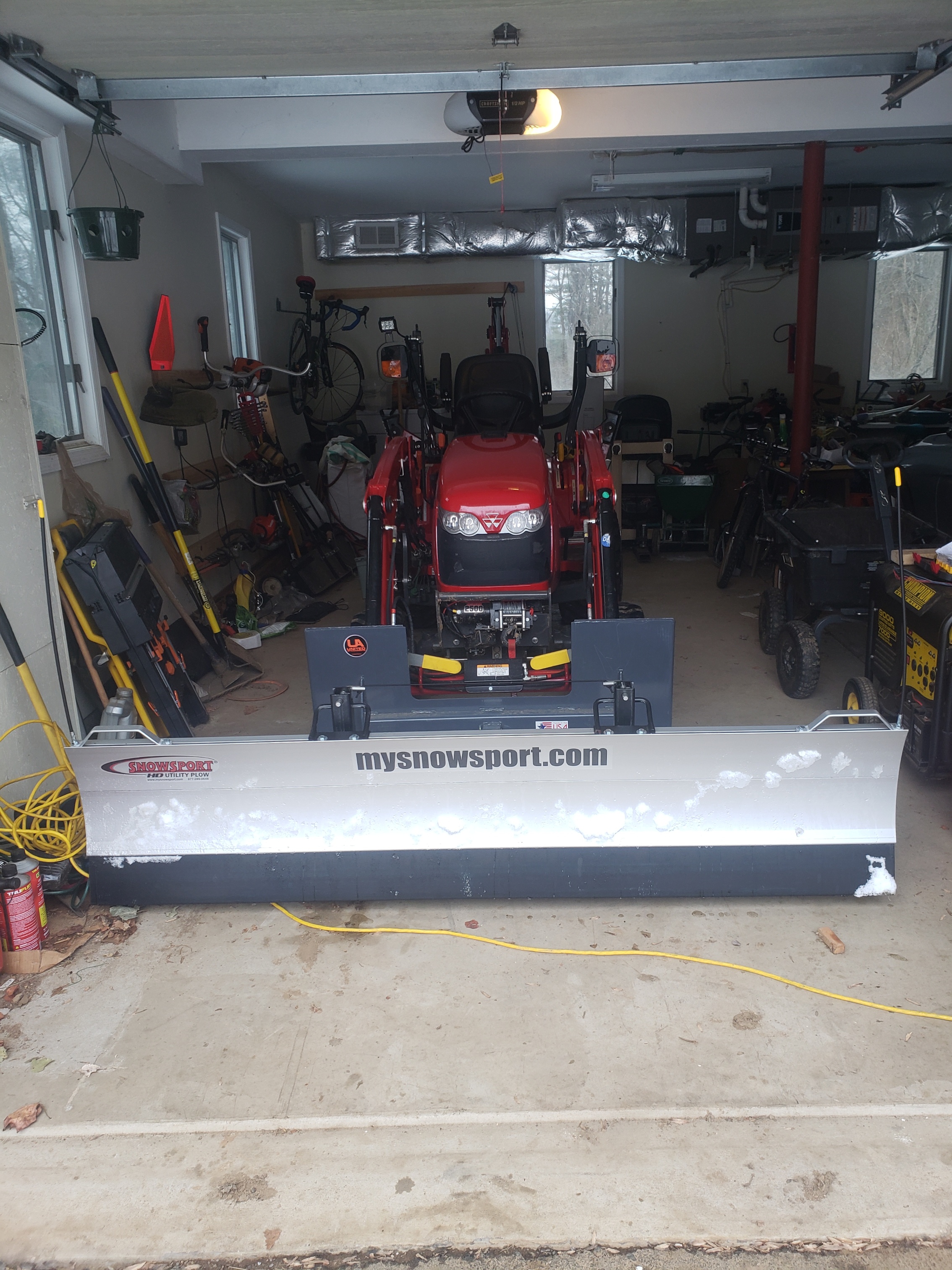

I want one for my massey scut. Tell me what you got, what size, what cutting edge you got, etc. Curious if having a back drag impedes how much snow it collects when going forward.
   / Hey cut/scut people with with snow pushers, tell me stuff #2
Had wings on this as a pusher, was a little hard to move over 6" or snow.
Took the wings off to use as a plow and much better traction, no chains and some mild slopes.
Plowed when we had 14" in two waves, no problem.

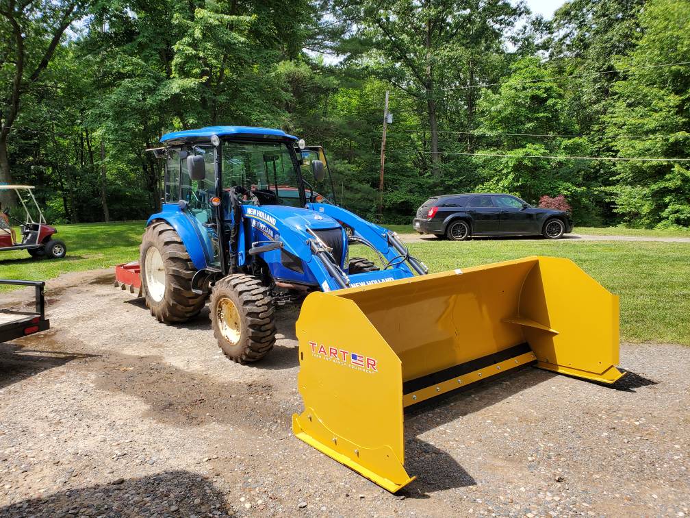

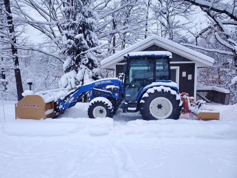

I bought an 8' from TSC for my Boomer 47. It is too big in my opinion. Rubber cutting edge seems to work good. I will cut it down to 7' sometime in the future. 6' would be to narrow for me. I use a back blade to clean up by my garage doors.20210208_180913.jpeg20190630_115724.jpeg

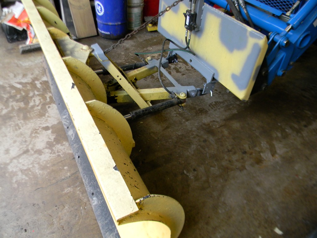

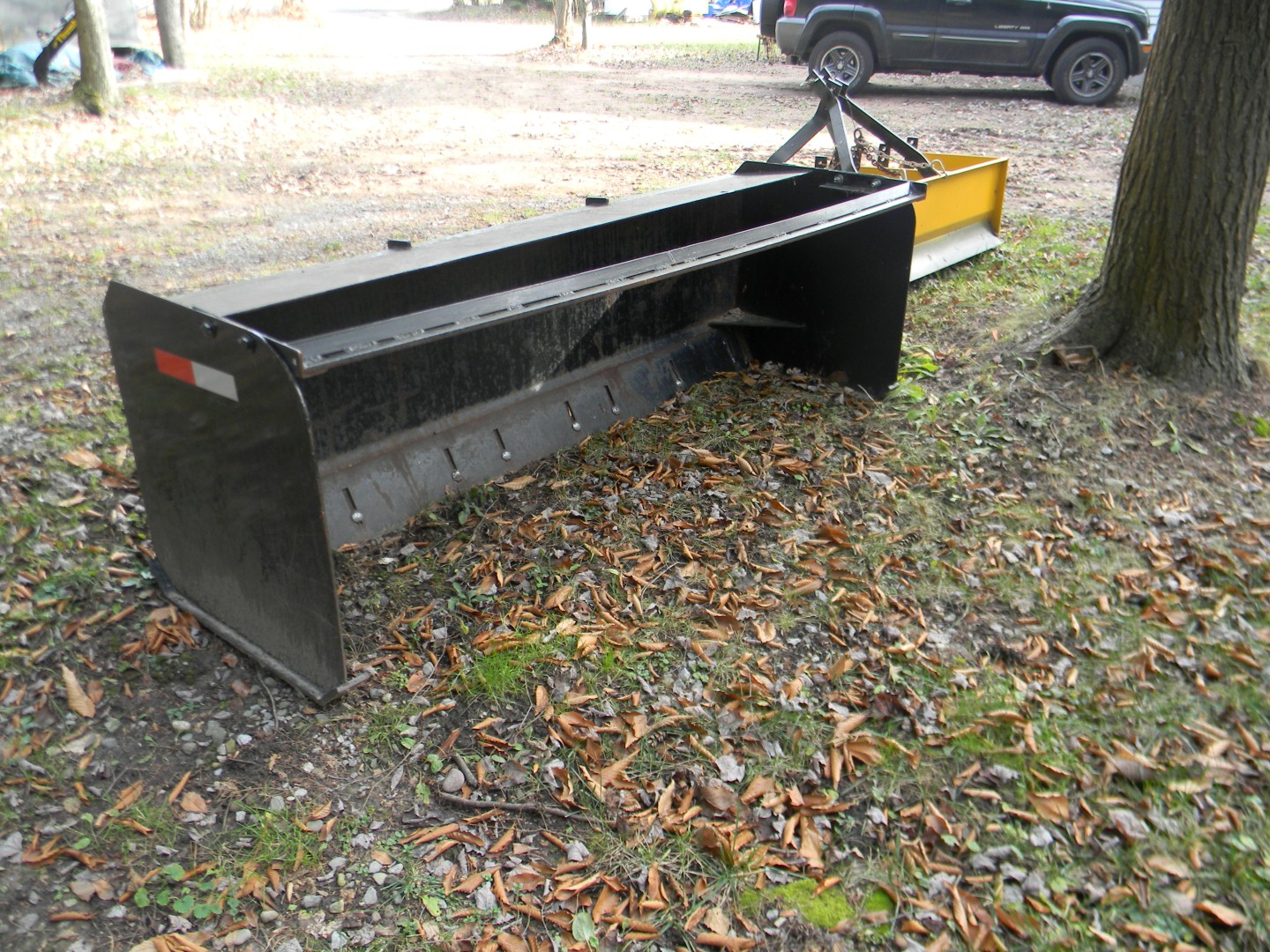

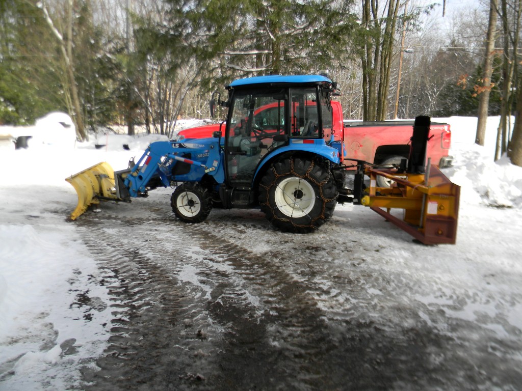

When I bought my tractor (LS XR3037HC) in 2014 I also bought a 7' pusher box with it. I did add a back drag blade which worked great. But, after one seasons use I sold the pusher box. I found that once the box is full of snow it only wants to go in a straight line. Even with chains on all 4 it didn't want to turn. I then adapted a truck 7'1/2' plow to a quick attach plate and found it much more user friendly. IMO, a pusher box is best used for straight line plowing such as a parking lot. My tractor weighs about 6K or more with loaded tires, a heavy 3 pt weight, plow blade and chains and is still not enough weight to turn a full box of snow.
If you do decide on a pusher I'd limit the width to 5' due to the size and weight of your tractor. I think you would be better to use the bucket or adapt a small 6' truck plow.
