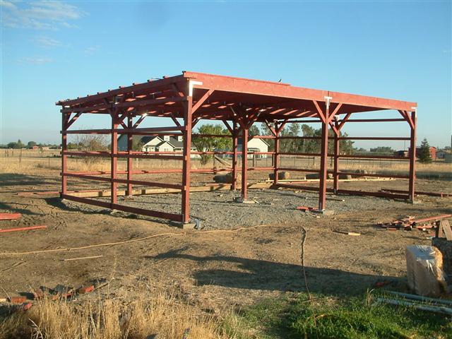

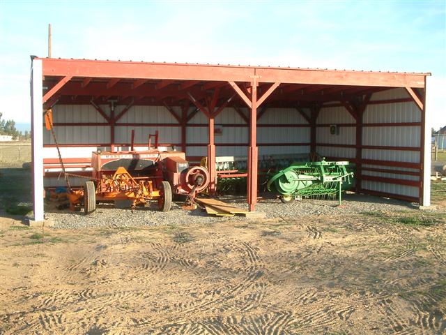

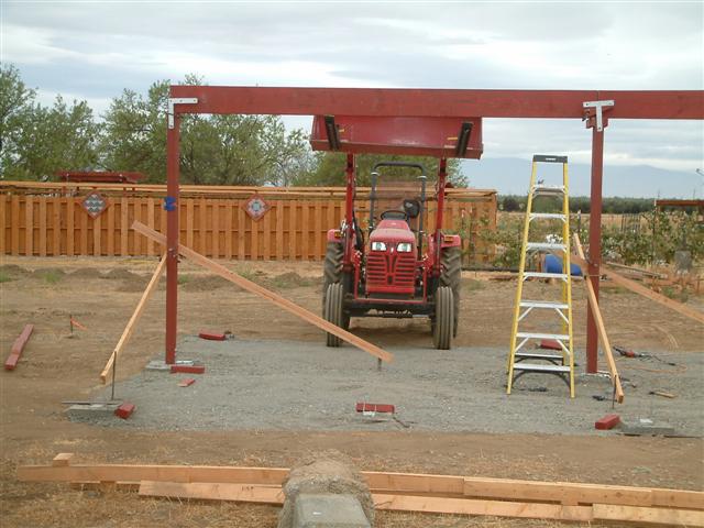

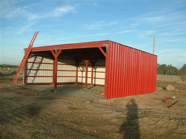

I used 4x6 pressure treated posts for my small DIY equipment shed (20x28 ft, 10 ft roof sloping to 9 ft in rear). YOu can use round posts, old telephone poles, etc.
Equipment shed-1.JPGEquipment shed-2.JPGEquipment shed-3.JPGEquipment shed-4.JPG
No trusses--just beams (doubled 2x12s and doubled 2x10s glued and screwed), rafters. Girts and purlins are 2x4s.
I like to paint the parts before installation (hate to stand on a ladder with a paint brush in my hand).
Sheet metal is 29 gauge R-panel special order from Home Depot (around $1 per square foot, IIRC).
Floor is just 6" thick layer of gravel.
Good luck.
