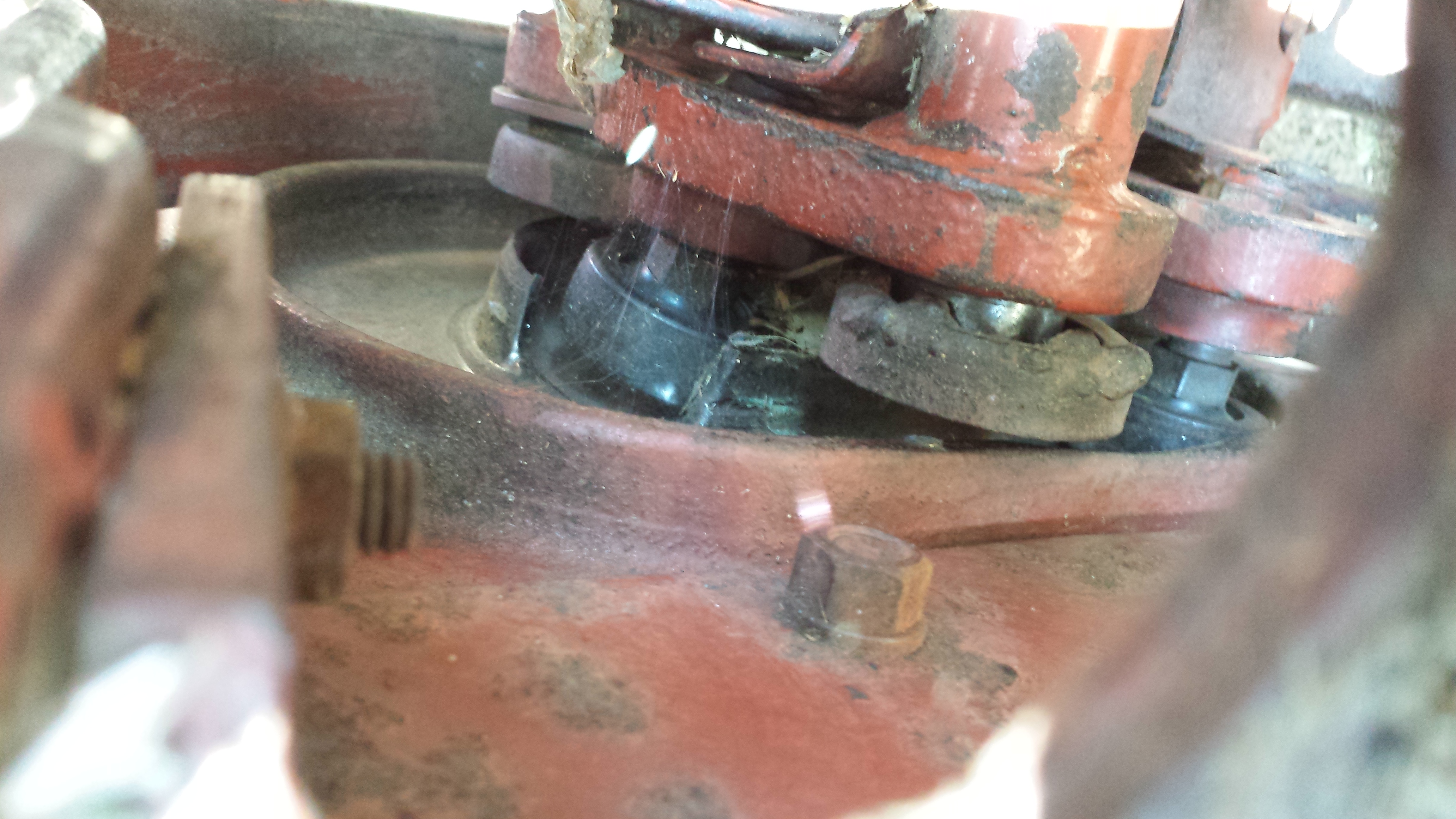

Would anyone with a Hesston 5530 or 530 be willing to post a picture of the track-cam plate?
I'm tearing apart my Pickup head to rebuild and noticed that the inside track in the cam plate has a gap in it. I'm not sure if it has a piece broken out and worn smooth or if it's machined that way.
Thanks in advance for any help.

Your baler needs a new cam plate. Track wasn't designed to have a piece missing.
