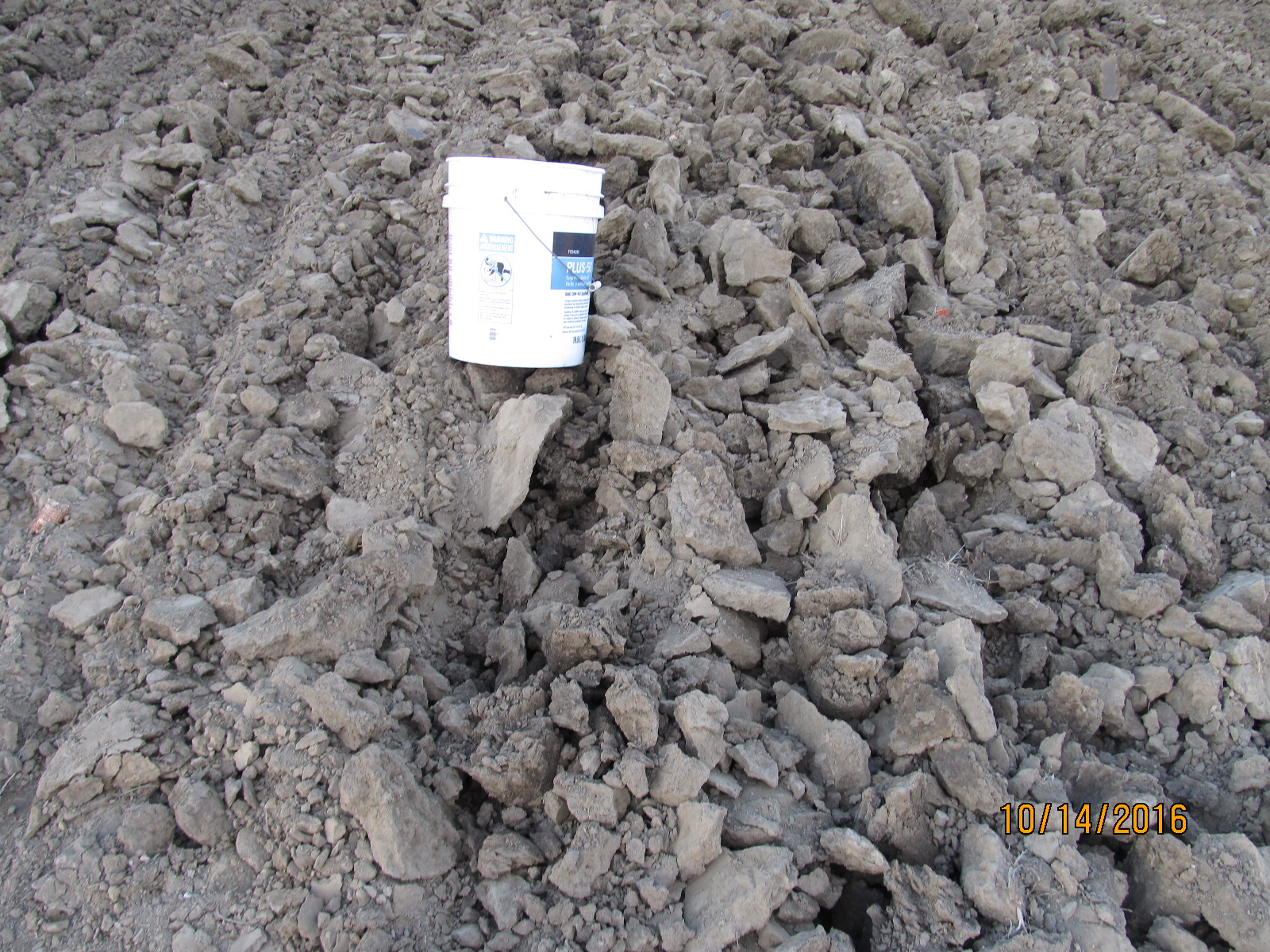

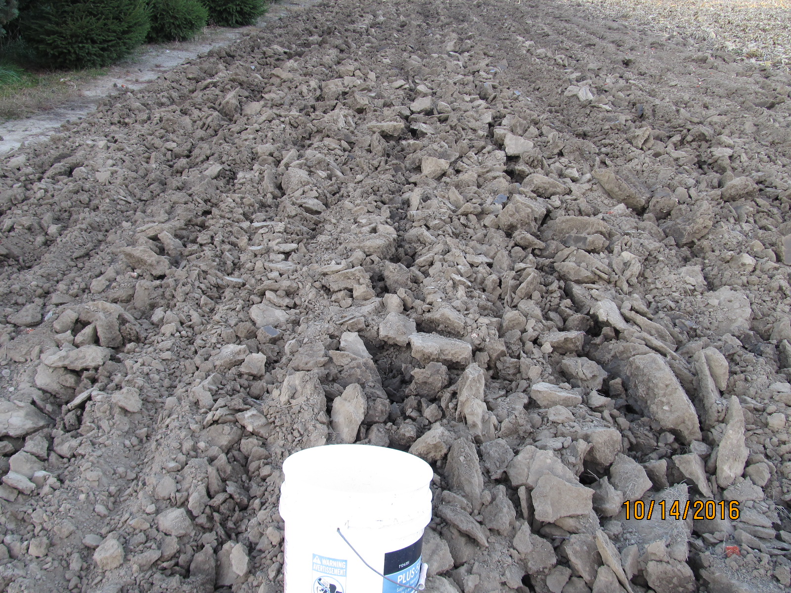

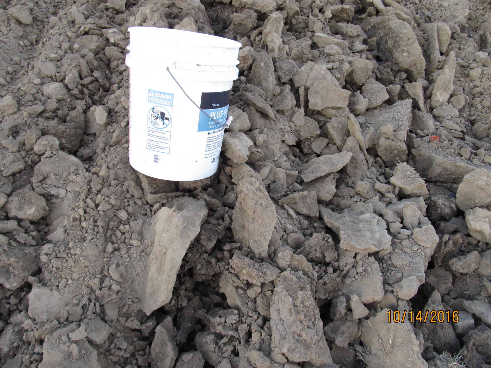

Compaction is a crop stealing problem on most any clay ground. Not so much on gravel because gravel doesn't compact.
Here are some pics after I subsoiled my sweet corn ground with a subsoiler/ripper. I went 12" to 14" deep and look at the chunks of hard clay that it brought up. Imagine roots trying to grow through that. There's a five gallon bucket for comparison. Think of the water that can now run into those cracks in the ground and how soft the soil will be for the sweet corn roots to penetrate.

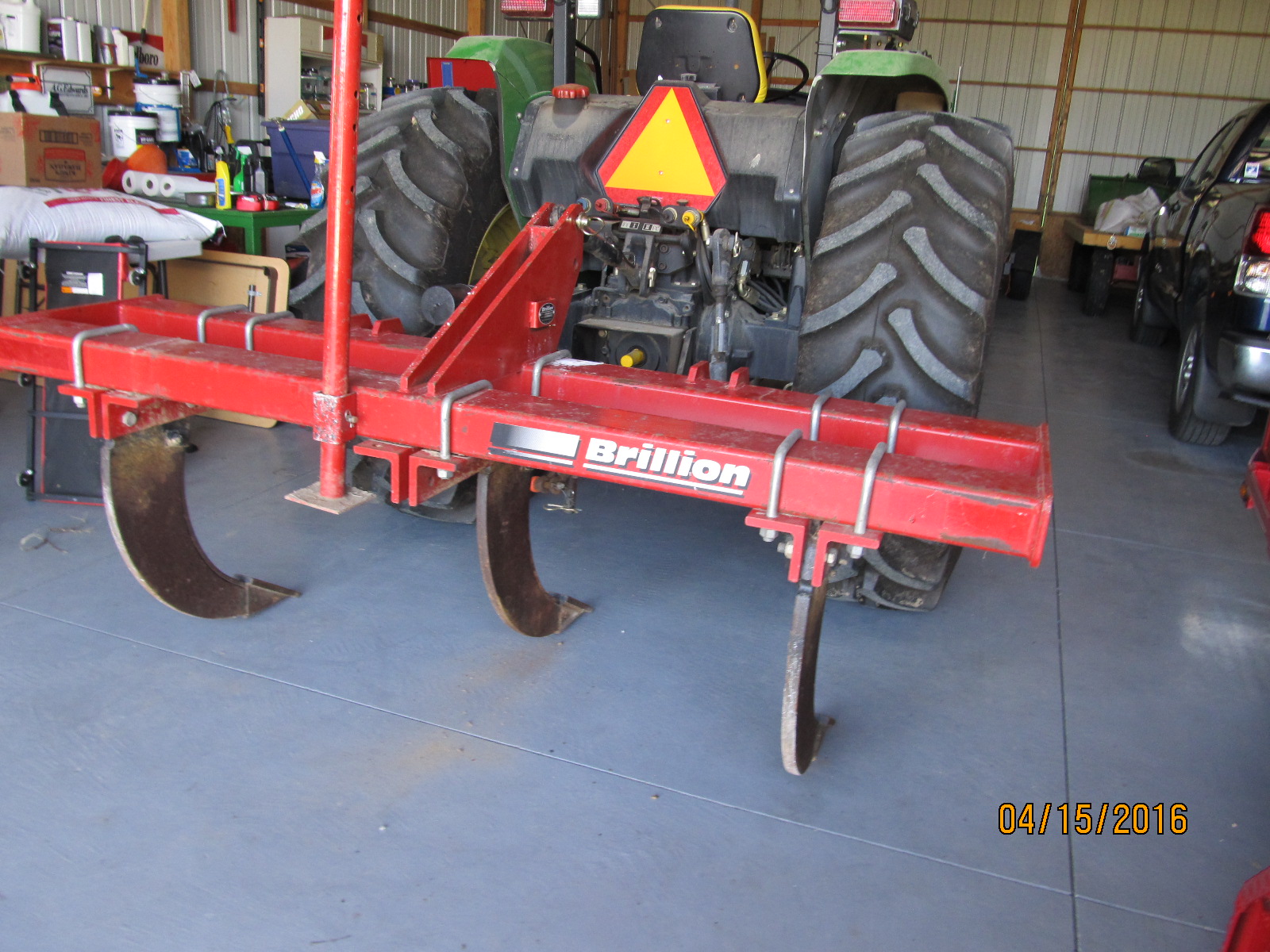

The compaction was caused by some tractor traffic and a fair amount of foot traffic. That's all. I used a three shank ripper but there are single shank models and 40 HP will pull one of those 12" or 14" deep. Deeper is no longer suggested because it can invert the soil layers and cause more harm than good.

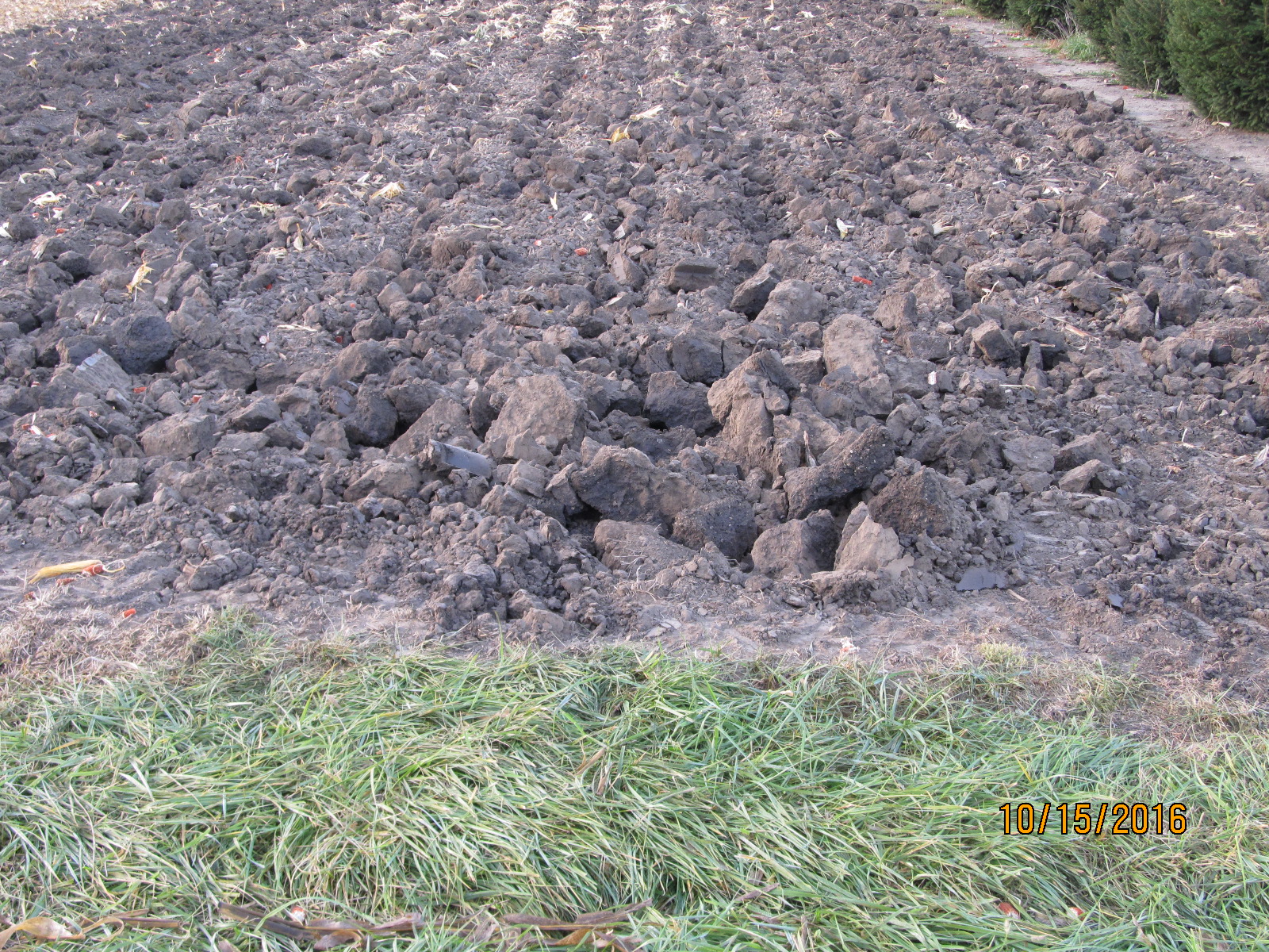

I'm the OP on this and here a couple more pictures of chunks pulled up at 12" to 14". Most of these chunks are 1/4 to 1/2 or a little less than the size of a five gallon bucket. Lets see your sweet corn try to grow through that ground. I still find it hard to believe the compaction that forms in clay ground when I think not much is occurring

Good advice and a great link to a subsoiling booklet. There are a couple things the booklet brings up that I forgot to mention. One is that the time to subsoil is when the soil is dry in August through the fall. Never in wet ground.
Second is that subsoiling can be done in two directions to assure the soil is loosened. Some guys will go one way the first year and then at an angle to the first ripping the second year. Some do it all in one year. Going two ways really loosens the ground.
There is mention in the booklet of 50HP per shank required but I think that can be too high of a suggestion. Maybe if two wheel drive and a lighter tractor but my 90 HP Deere 5520 with weights, radials and four wheel drive pulls three shanks @12" to 14" just fine in dry and hard ground.
