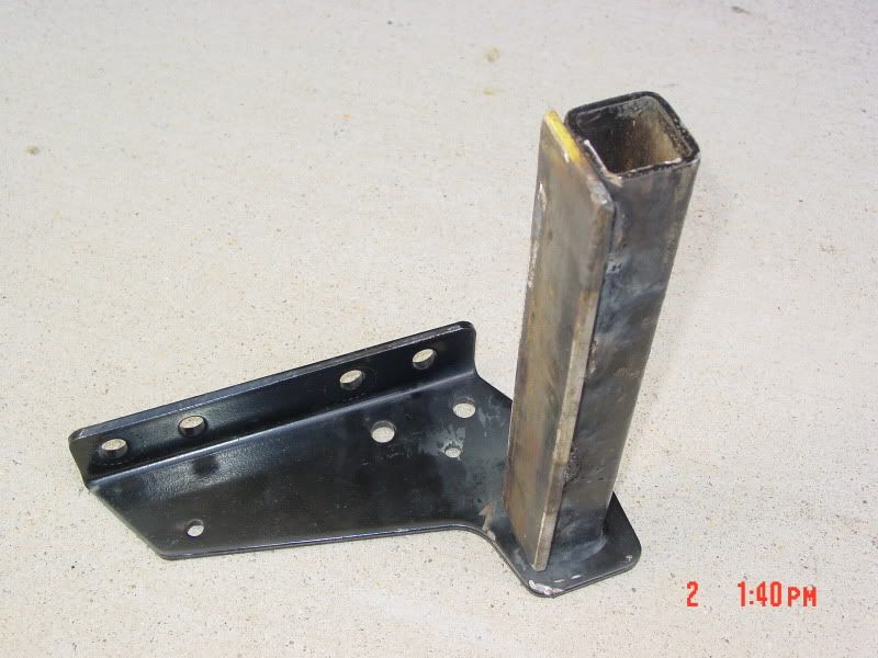

The Model 70 loader has brackets for the loader masts made of 2" (ID) square tubing that are open ended so I decided to try and use one of these as a mounting point for my chain bucket. I happened to have some mounting brackets left over from an adjustable width frame mounted receiver hitch (for a car/truck) that I had bought off of CL. I used the center piece of it to make a 3pt handy hitch, so I decided to see if I could "recycle" one of the end pieces to become a mounting point for the bucket itself. I wanted the bucket to be easily removable, so this seemed like the best way to go.
First off, these mounting brackets are actually 1 1/2" OD square tubing, so I welded on a 1/4" thick piece of 2" wide flat bar stock to make up most of the difference. I then only needed to take the grinder and round off the corners of the 1/4" bar stock and it fit right into the loader mast mounting bracket. It fits pretty snug, actually. Here is pic of the the modified frame hitch mounting bracket:

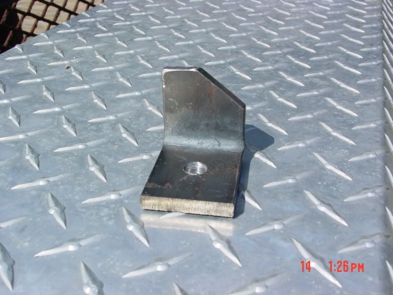

Next I needed a small angle bracket to be welded to the loader mast mounting bracket. The only purpose of this little bracket is for a 3/8" hole so a 3/8" pin can go through it to make the assembly removable. Here's a picture of the angle bracket I made up from 1/4" x 1 1/2" wide flat bar stock:

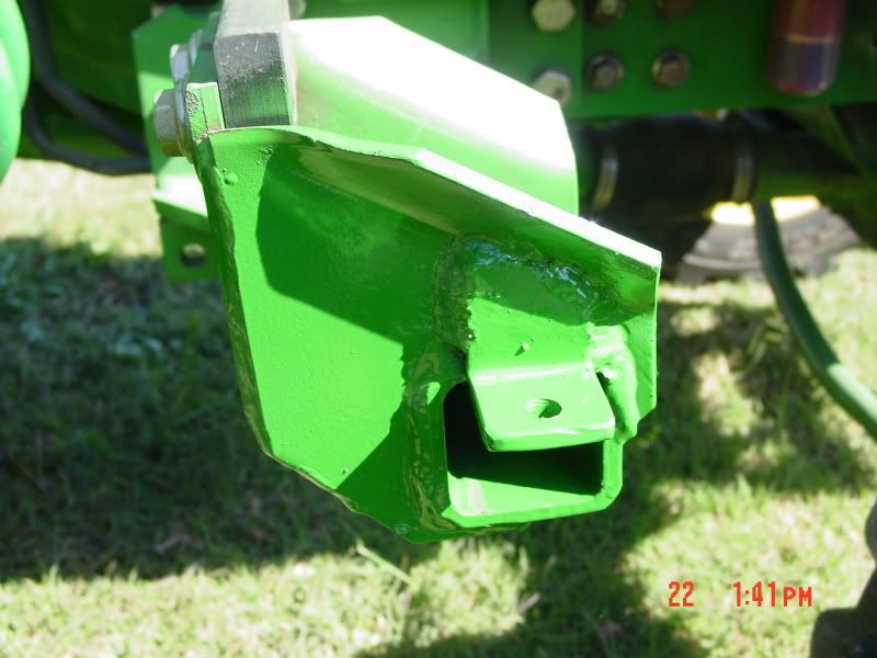

Here's a picture of it after a neighbor welded it to the loader mast mounting bracket for me, and I threw a coat of green paint on it:

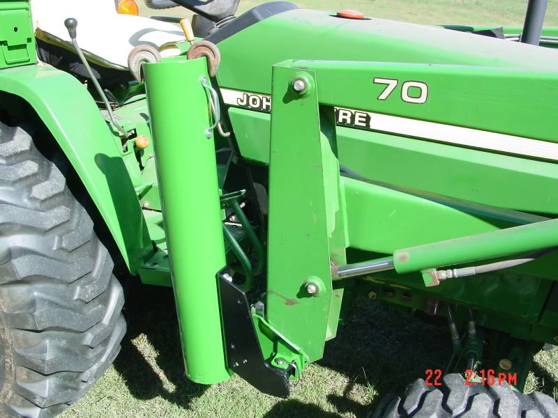

And here's the finished product, all painted and ready to go with my 20ft chain installed! :thumbsup: I'm going to use it for a while and see how it works out, I may decide to shorten the length of the tube some. Right now it's about 28" long, but it may not really need to be that tall. Believe it or not, it doesn't really get in the way of my foot or leg when mounting the tractor from that side. I think I have some extra room in it for maybe a big hammer, a big adjustable wrench, and a prybar! :thumbsup: Now I just need to come up with a good story for what it is, when people ask me, "what the heck is that thing"? Maybe it's a mortar laucher!! :D

Very creative, recycling to boot and ending in functional, practical and visually appealing. Nice Job!! :thumbsup::thumbsup:
   / Here's my chain bucket... #3
Nice job Kebo! :thumbsup: I keep wanting a chain bucket for my tractor too....maybe I'll get inspired one day. Nice work.
   / Here's my chain bucket... #4
Nice job on the 'mortar launcher', can ya make one in red? :thumbsup:
