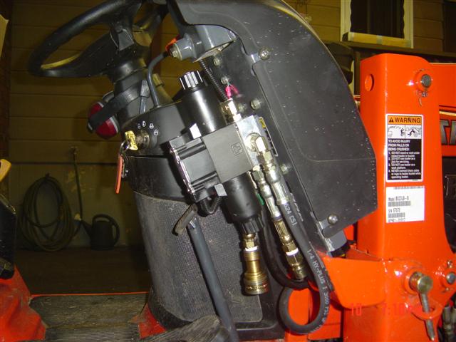

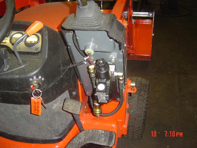

I went with the Elec/hydraulic kit that WRLong sells. It is a bit expensive but WOW what a slick operation this is. Easy (I mean real easy) installation. I had maybe an hour into it including the wiring. It comes with a mounting plate and all needed hoses, including the QD to cylinder ones needed to actually run the grapple. That was a surprise to see in the kit.

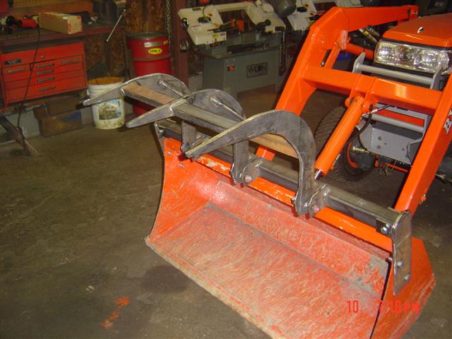

A couple of preliminary pics. Building stage. Grapple closed.

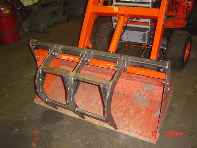

Grapple Open

Electric / Hydraulic valve shot

Same valve different angle
