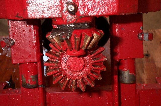

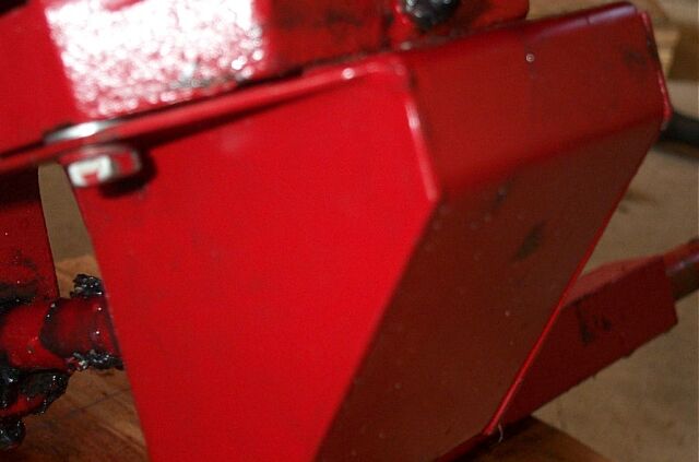

Jun 28, 2003 / Herd Seeder 96 Modifications #1 NY_Yankees_Fan Veteran Member Joined Mar 4, 2002 Messages 2,206 Location Warren County, NJ (60 miles from NYC) Tractor Kubota BX 2200 I was cleaning the seeder today and noticed the guard protecting the gears held water. So I took it off and drilled two holes so the water would drain from the guard. Poor design I thought. Attachments 286420-guard with holes.jpg 96.5 KB · Views: 306
Jun 28, 2003 / Herd Seeder 96 Modifications Thread Starter #2 OP NY_Yankees_Fan Veteran Member Joined Mar 4, 2002 Messages 2,206 Location Warren County, NJ (60 miles from NYC) Tractor Kubota BX 2200 I can not get grease to the fitting without removing the guard. My grease gun nozzle is just a little too big. Attachments 286421-no guard.jpg 65.4 KB · Views: 251
Jun 28, 2003 / Herd Seeder 96 Modifications Thread Starter #3 OP NY_Yankees_Fan Veteran Member Joined Mar 4, 2002 Messages 2,206 Location Warren County, NJ (60 miles from NYC) Tractor Kubota BX 2200 So I added a washer on either side and the grease gun fits perfect. Just a little fine tuning. Attachments 286422-washer.jpg 34 KB · Views: 228
Jun 30, 2003 / Herd Seeder 96 Modifications #4 A Anonymous Poster Epic Contributor Joined Sep 27, 2005 Messages 29,678 I store mine upside down and that seems to let all the water drain.
