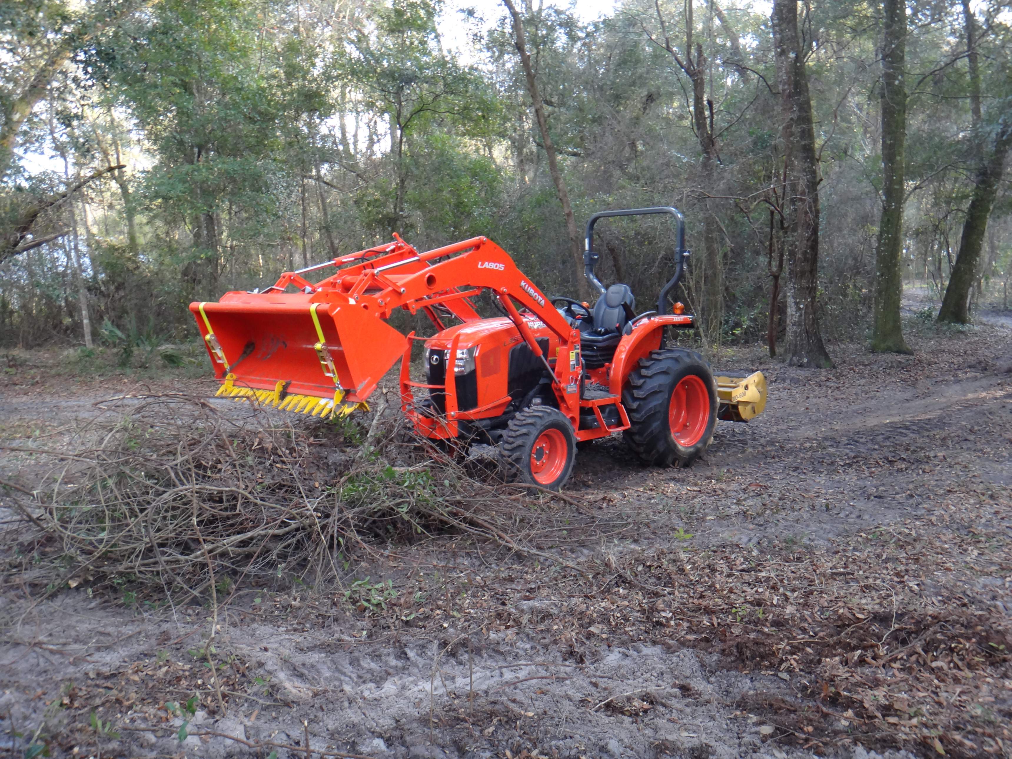

I have been pulling 1" - 5" diameter wild Vitus Rotundfolia (Scuppernong) grape vines out of Oak, Hickory, Persimmon and other valued trees in a north Florida residential common area for a year.
That part of the job is done. Above ground vines have been transported to the community burn pile and incinerated.
Vine shoot are sprouting from residual stems/roots underground.
What should I use to kill this new vine growth completely? Roundup? 2,4-D? A specialty brand of herbicide?
{I have TSC and Ace Hardware close by; Southern States Co-op further away.}
Which season is the most effective time to apply herbicide to wild grape vegetation?
