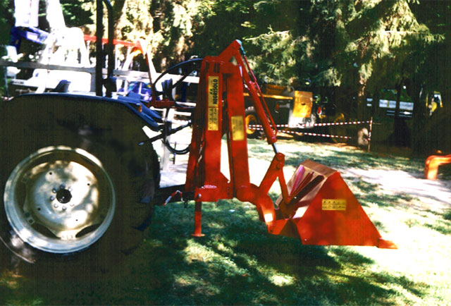

My neighbor used to build a type of rear lift loader that had a power dump and he made a homemade scissor type lift to rase it. It could raise 66 inches high. and go 2 inches below grade. He used his to make a trough lower the tailend of his single axle log truck. to load with the fork attachment on the same lift. Ive made a few of the gravity trip dump buckets on scissor type lifts that work well to. Theres several companies that make them all over the world for small farm tractors Ford even had them in the 30's to the 50's. Warratah used to also make them in Austrailia that hade a straight boom and a trip bucket on a scissor type lift and Negrisolo also makes one that looks like a one armed loader on a 3point lift with a cylinder to do the work. I made a one armed loader for the 4000 Ford at work out of 4x4 tubing with a cylinder and an old trip bucket off a Dearborn manure loader. What made the loader with the one arm and cylinder so handy was after scooping the load you could raise the 3 point and it got the load off the ground about 2.5 feet then you pulled the remotes and it raised way overthe cab of the tractor. Then it could be dumped by a rope. I made the first one light wieght and was showing out infront of a friend and tried to move a 2000 pound rock and bent my channel iron bucket mounts. I need to reconfigure it.

Heres the Negrisolo loader

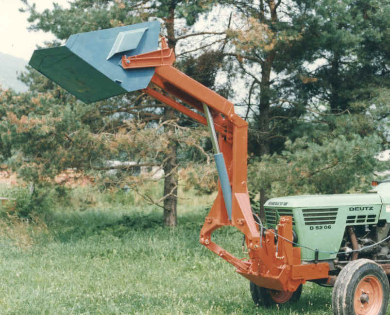

I cant remeber the name of this loader its mountable on the front or rear 3 point hitch of a tractor
