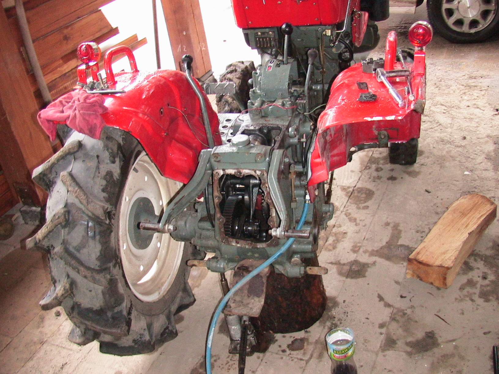

Hey guys I recently purchased a 2210B(after selling my 165d). Everything works except the differential lock. Did not find out until I needed it while brushchopping.Any advice would be appreciated. what is the sequence to take apart to look at the fork?

My 186D was like that when I bought it. I had a shop, former Yanmar importer, open it up because I thought it meant tearing down that whole Powershift transmission.
At least on mine it turned out to be far simpler. In summary take the pto cover off the back, drive out the rollpin between the fork and the rod, pull the rod out the side after removing the fender.
I hope yours is built as simple as this.
On mine the dogs between L/R axle were fine. The difflock wouldn't engage because the rollpin had worn a cavity in the fork, so the fork was no longer pushed far enough to one side. (The rollpin rides in a 'V' on the side of the fork, so pressing the pedal slides the fork away from the rollpin.)
Welding up that worn spot on the fork fixed it.
I posted about this here, probably last August, so a search should find it.

Assuming you have checked out your pedal all the way to where it goes into the transmission housing. No pins sheared or anything? I'm going to try and post a picture of a 186d which should be similar to yours. The picture shows the pto removed and is as good a picture as you will see showing the differential lock and fork. Hope it works and helps you. http://www.tractorbynet.com/forums/...1273438130-broken-power-take-off-img_2632.jpg

My 1510d had a very stiff diff lock and one time when I had all the internals out of the rear--pto and 3 pt lift--I took the shaft out and cleaned up the bearing points. It works as it should now--before I would engage it and then had to physically disengage it when I was out.
It is not too complicated and not difficult to work on. I was afraid that I would not be able to slide the fork mechanism against the spring to put the roll pin again, but it was not hard.
