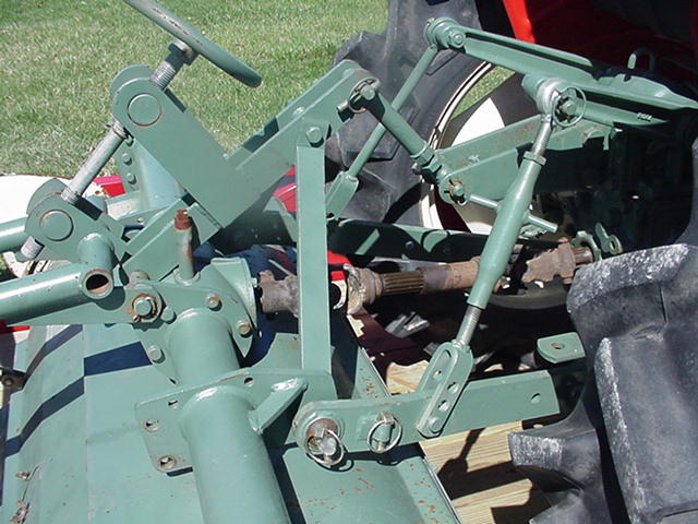

I just bought a Yanmar RSB1300 tiller for my ym 2000. Nice looking piece of equipment, with lots of wheels, levers, and cranks. But to my dismay when I got it home and tried to hook it up to the three point on my tractor it seemed as though the top link was way to long the bottom arms way too short ann the PTO shaft too long, tiller too close the back wheels. I need help I am missing some thing here but did'nt want to go off half cocked. My first thought was to see if I could get about a 8'' top link and cut the PTO shaft down. but that would still leave the tiller about 2" off the back wheels. Thanks for the help.

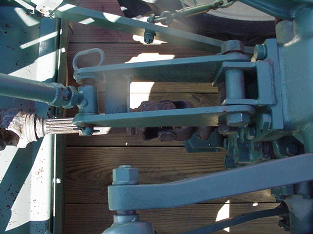

Original hookup used a double jointed top link affair. We always sell it WITH the tiller, as it is essential for hookup to keep the tiller out of the tires when lifting it. If you look closely at the back of this tractor Tiller top link you will see the linkage used. The 2000 takes one slightly different, but the principle is the same. It moves the point of swivel about 10" further away from the tractor. (Thanks to Aaron Hoye, as their website had this picture readily available, while we, in our typical Midwestern modesty, prefer not to show our tractor's naked behinds /forums/images/graemlins/grin.gif) Some dealers may have an extra they can sell you....we might, but I'd have to remember to look, and that's a long shot. You're welcome to email if you want me to look.
   / Help!! YM 2000 and RSB1300 tiller hookup? #3
Here's a picture of my 2210 hookup with an RS1400. I think it might be similar.

Another from the top...

Nice pictures they'er were a 1000 words, thanks for the for the info everbody else. My tiller was missing the top link and the pto shaft is alittle too long. I should be getting a shorter shaft and the top link set latter this week. Oh boy I can't wait till it gets here. Garden is just achin to be tilled. Which speed do you guys till in My tractor has 3 pto speeds. what rpm and gear. Thanks
