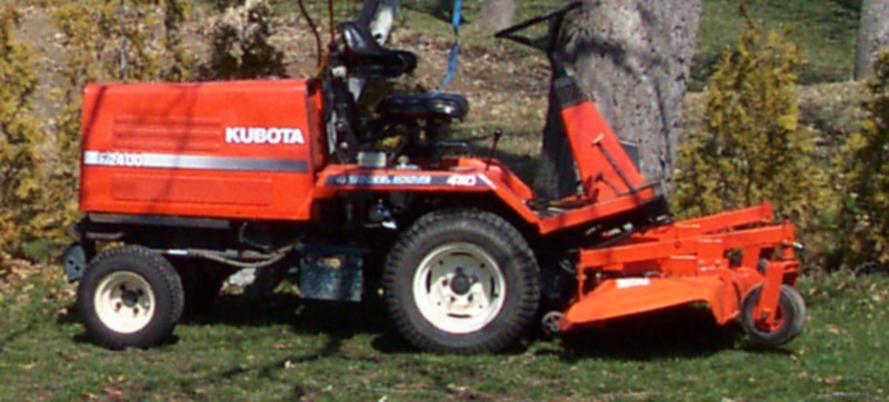

My suggestion is to look for a good used Kubota F2100 or F2400 - like the city parks departments and golf courses use. They are built like tanks and will run forever. You can probably get one for around the $5000 price tag you suggested. If you have any significant side slopes such as ditches, be sure to get a four wheel drive unit (I think all F2400s are 4WD but some F2100s are 2WD). I bought a F2400 two years ago. It was previously owned by a small rural town. The hour meter was broken at just under 4500 hours so who knows how many hours are on it. The dealer fixed that before I bought it. The main thing it needed was a lot ot TLC. The only thing I have done to it mechanically was replace the alternator. It will last as long as I need it and then I will be able to sell it for at least as much as I paid for it.

WOW! 4500+ hours, and still going. Great info! Also a good idea. (to find one used) I always try to find a gently used (whatever) before looking new. With my Kubota, I plan on keeping it as long as it will last, so I didnt have a problem buying new. Which is saying alot for me. Matter of fact, it's the first of anything over $2000 I've ever bought new!
Glad I did though. No regrets. Hopefully it will out last me.
