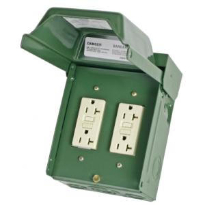

I need help on running some wire to get power out to my garden.
I have a breaker panel box thats's on the outside of our house in it has the main breaker for the house and the breaker for the well pump & a breaker for the lawn timer.
There are still about 6 spaces left for more breaker's to be installed.
I would like to come off this panel and run the power out to my garden for running two small water pumps ( on a timer ) and any power tools I may need when I work out there.
The garden is about 100' or less for the outdoor panel.
So what size wire would I need and what size breaker would I need.
Was looking and maybe doing like this kind of box in the garden.
# Includes 2 GFI Receptacles
# Two 20 Amp GFI
# 120 Volts
# UL Listed
Thanks for any help
Ron.

Good choice on the GFI that is pretty much a code requirement any more. 10 guage wire would be my first choice for that long of a run. Use underground rated wire even if you put it in a pipe. When you lay the wire go plenty deep so that you don't hit it later on. Take a picture and make a map of where the wire is and how deep. If you sell the place or need someone to come in and do the work then they can use that as well. I used a 25 amp breaker on my breaker box to run my compressor. It ran pretty close to 20 amps and the start surge would trip the breaker at times. If you are using 20 amp receptacles out there then you might use 20 amp breakers. I am not an electrician and familiar with code. Just an electronic geek familiar with Transistors and tubes.

For that long of a run and since you're going to put it in conduit anyway, you might consider single-conductor 10ga THHN wire and 12ga bare for the ground. Might be a little less expensive than underground 10-2 WG.
   / Help with wireing #10
tile,
I have been in this trade 30+ years. Here's what I'd do if it was my house. I'd use 1" PVC conduit because I want the option to pull it out if something ever happened. Then I'd use either 10/3 w/ground UF cable or 4 separate runs of #10 THWN (THWN is for a wet location) single strand wire. 2 blacks, 1 white and 1 green. The reason for the 2 circuits out there is you have 2 receptacles. Why run them on the same circuit? That's what you'd have if you ran 10/2. I'd run #10 because of the voltage drop issue if you want to run power tools. You said you did. I'd bury it 18-24" deep. Put it on 2 20Amp breakers or 1 2-pole 20Amp breaker. You said you'd be tying it into the breaker panel that has the main breaker for the house, so I'd assume that is the "Service Disconnect" for your electrical service. Connect the wires to the breakers as you mentioned. The white and ground might be able to go to the same buss depending on local codes. Both of them are connected together right there anyway. If you have 2 separate busses then use them appropriately. No disconnect or grounding electrode is needed at the garden power outlet if there is no structure there that has power in it. You can install one of you want, but I personally would not.
