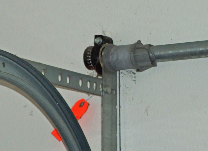

Had sim problem with opener recently. Wayne Dalton has had several different designs over the yrs. Mine has 2 tension springs, one on each end, adjd independently.
Cable was so loose cable got tangled around the drums. Straightened out the tangles, put the door down and increased tension and watched as I raised the door and made sure cable wrapped properly on the drums. Fine tuned the tension after raising the door so cable has just a little tension on them in the up position. When adj finished, made sure the jam nut on back side of the worm screw was tightened.
Referring to the pic, the hex head is not a bolt for attaching the mechanism to the wall. It is the drive on a worm screw for adj tension. There is a indexed wheel on the end of the shaft to help with tension. With the dual adjmt I made sure both ends were the same.
Door has worked well since afjmt made several months ago.

Thanks for all the replies.... One I was working on is close in design to Mickey_Fx photo... Tried to copy a portion of the manual but couldn't.
Today I went over and worked on adjusting one more time... I tightened the lift cables.. and found the latch unit stuck in the closed position ... so everytime door went up it would keep door from going down..
Just glad I was able to get it working.. and again thanks to everyone for there help..
