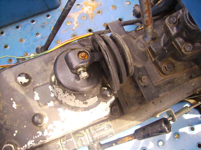

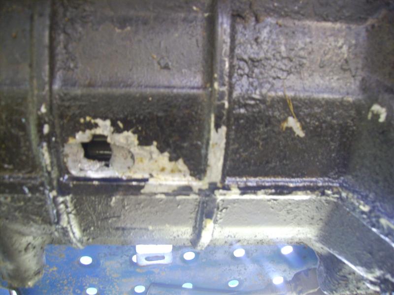

It finally warmed up enough to allow me to dig into the leak. I've attached a picture of the damage. Now I have my 1st problem. How do you remove the shifter. I loosened the bolt that appears to hold it to the shaft but after tapping with a hammer it will not budge. I've attached a pic of what I'm talking about. Thanks in advance.

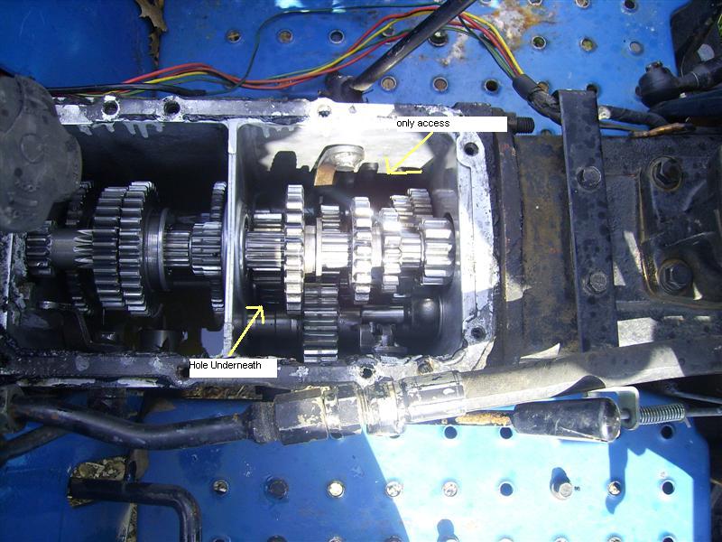

Hurrah, got the shifter off. Patience, WD40 and time. So here is what I'm up against. I've attached a picture showing where the hole is and the only way I can access the bottom of the housing. I probed the hole with a piece of wire and can hear the object moving around. So I guess I'll go buy a flexible magnet or parts grabber and see if I can pull it out. If I'm not able too, can the gears be removed?

I got it out with a small magnet. It's a 7/16's bolt about an inch and a quarter long. I'll get a picture on it this weekend. It came out intact other then being beat up. And I can find no damage to the gears.

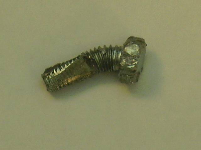

Here a picture of the culprit. Doesn't look like a transmission part to me.

I agree with Marada, gear case bolts are not plated. Is the markings on the head visible? If they are not metric then you can be assured it did not belong in there.

The only thing I can make out on the head of the bolt are the letters "JD". There are numbers on the opposite side but there banged up too much.

Get a telescopic flexible mirror and a flashlight and inspect all over inside the case. Look up at the gears from down under shinning your flashlight at the mirror. Look for damaged teeth and a missing bolt. Rotate the gears and inspect some more. Especially inspect the area of the gears where they poked the bolt out through the case. Try to rotate the transmission in each of the gears to see if they will work before you "button" it up. If there is no damage you got off lucky. Make sure you clean out the bottom of the case for any loose chunks of metal. Then you will just have to repair the hole. Sounds like a good job for JB Weld.
