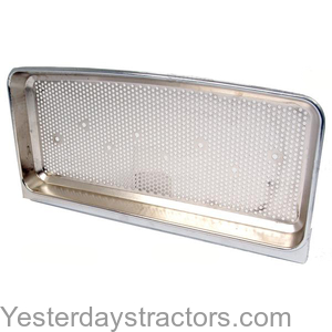

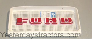

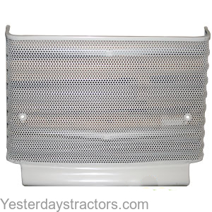

know what years and styles 5000 came in?
example:
Ford 5000 Grill Insert Upper - C9NN8A163AG
1971-1975
And
same as above except for no emblem, holes yes emblem no 1968/1970 5000
Ford 5000 Grill Panel, Upper - C7NN8150G
And
this what I think my lower looks like 1965 to 1968
Ford 5000 Grill Screen - C5NN8202AA
similar to other vendors also...
