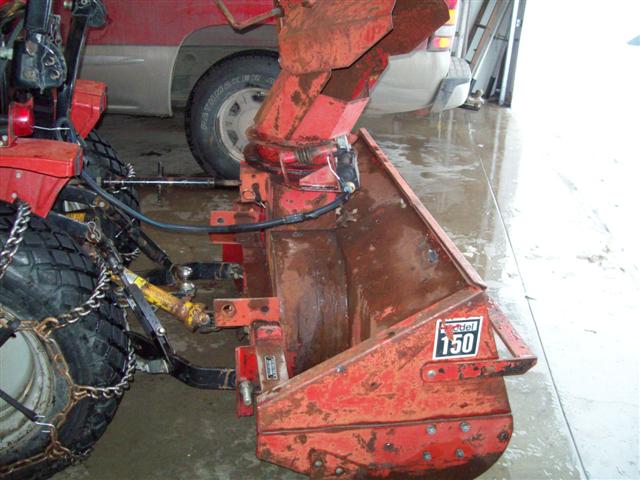

Hey all, I need some help. I recently purchased a 48" 3 pt. blower. I picked it up from a guy on cragslist for $750. It is red and has an electric shute adjustment which works great. We have it hooked up to our Case 235 and got it adjusted but when we tried it out for the first time, we were breaking shear pins like crazy. It just won't throw any snow at all. Even if we lift it up and just shovel snow into it, it won't throw it out. The seller told us it was a 540 RPM blower, but I am thinking it isn't and might be turning too slowly to blow the snow. I don't have a picture of it and don't really know the make of it. It has a white sticker that says Model 150, and a metal tag that reads.
OLATHE MANUFACTURING, INC.
150 150105 4/87
Can anyone shed any light on what might be the problem?? We just had a major snow storm and would really like to get this baby up and running.
Thanks for anyone that has any ideas!

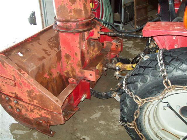

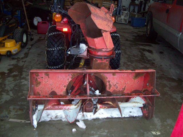

OK, I think I did a poor job of explaining. Everything seems to be moving ok when hooked up. The auger turns and the blades (impeller) spin. It's when we put any snow at all in there, even with a shovel, it just spins around where the blades are until it just plugs up and we lose another shear pin. In the picture looking in the blower, the impeller spins counter-clockwise which seems to make sense because there are curved edges that would throw the now up and out of the shute. Let me know what you guys think. Also, what is the other shaft on the back of the blower for? It was obvious that the one we are hooked up to because it was the only one with any signs of use. We did hook up to that one but it didn't seem to make a differance.

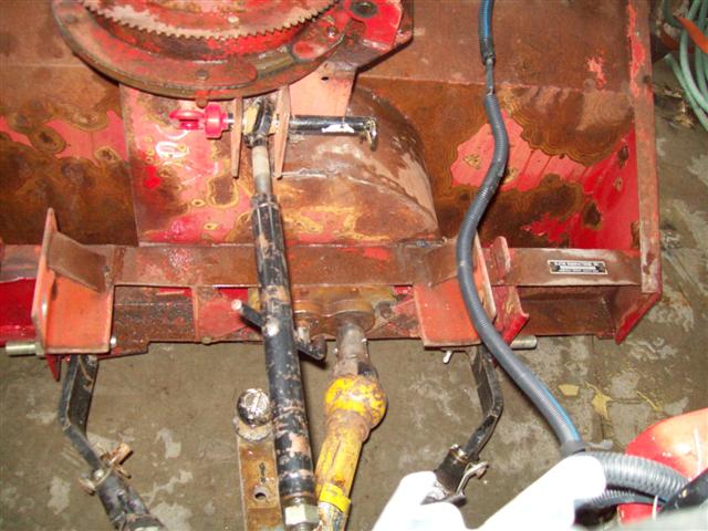

It sounds like its turning the wrong way, but your description has it turning the right way. My interpetation of the pics is the shaft youre driving is geared to the actual blower spindle [that other shaft], turning it the opposite direction that your pto turns. According to the pics and your description that is the right way and it should work...but it doesnt. :confused:

The picture of the impeller looks unusual, it almost looks like the impeller blades are curved surfaces rather than the normal fins I've seen on every other impeller. Maybe it's just an optical illusion. Is it possible the fins are bent backwards, which would explain why they no longer throw snow out of the chute?
I also don't understand what the second shaft connection is for. If you disconnect the PTO shaft and turn the auger by hand, do both of those shafts turn? Is it possible there's a gear reduction that allows connecting to different speed PTOs depending on which shaft you connect to?

Looking at your shaft it looks like the angles are wrong. I believe that shaft should be hooked up as straight as you can get it. It looks cock-eyed to me. And it looks like the connecting point at the blower is very low.
I don't suppose you can call the guy you bought it from and see if he has any ideas...
You are correct, the fins are bent. If you are looking right at the impeller, they would be bent to make kind of an "L" shape to the right. To kind of scoop the snow up the shute.
It appears that the other shaft makes the impeller turn the other direction. I guess you could hook this up to a PTO that spins in either direction.
So, is it just a RPM thing?? How fast should this thing spin?? If is is not spinning fast enough how could we speed it up?

That impeller has to turn counteclockwise in picture 2 or clockwise looking from the tractor. So which way does it turn???
Is that gear box a 1:1 or is it an increaser???

The two different input stub shafts seems odd. I don't know if its a picture illusion, but the shaft that your hooked up to seems to put the drive shaft at an angle. The other input shaft looks to be more in line with the top link which would seem to make the driveshaft connection straighter. If so, I would probably connect to that one.

Those are both correct. Looking at it, it turns counter clockwise. From the tractor, it would be clockwise. I don't know anything about the gear box. I do know that the PTO, looks like it is spinning a heck of a lot faster than the impeller.

Just an observation from looking at the pictures ...... isn't the angle of the pto driveshaft extreme ?
The left side view which shows the chute motor looks a little radical.

One of the other snowblower threads said that a 540 RPM snowblower impeller should turn at 540 RPM. Rotate your driveshaft 1 turn and check if the impeller rotates 1 turn.
Hooking up to other input shaft makes impeller turn the opposite way? I would say THAT is a big difference. The impeller is turning the correct way (CCW looking into blower) hooked up the way you have it.

The other shaft is probably there just in case the one you are using is turning it backwards. It looks like there is a gear set under the cover and the shaft that you are connected to is probably supposed to be used when the blower is front mounted to get it the turn the correct way.:eek::eek: As it is now the impeller is probably turning the oposite direction of your pto shaft.:eek::eek:
