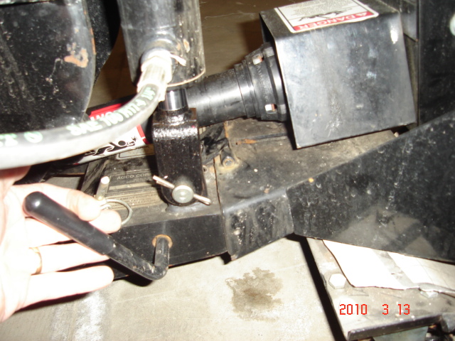

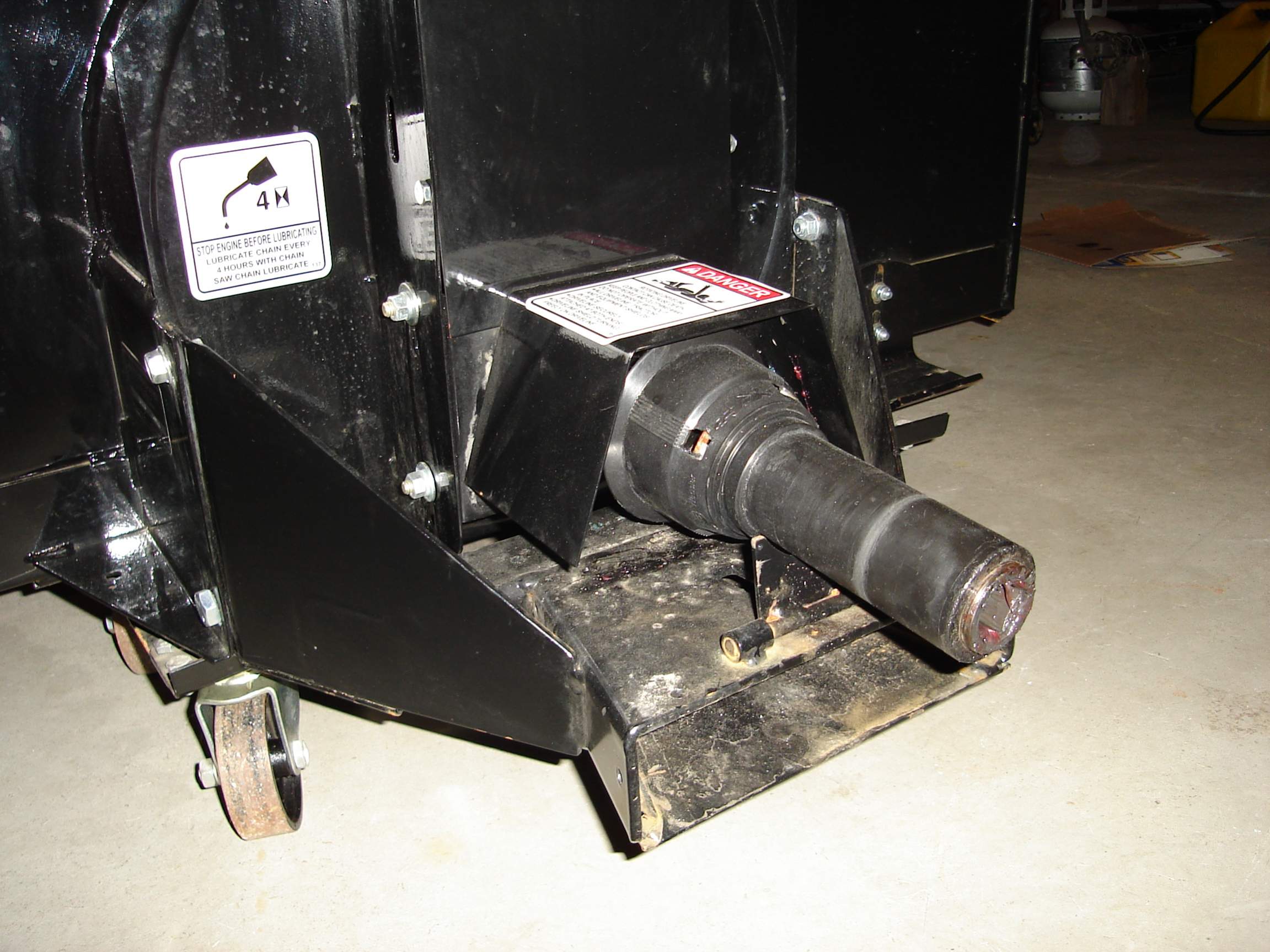

If you're talking about removing the short shaft from the back of the blower, you don't really need to, though it can be done; its locking ring is pretty deep in there.

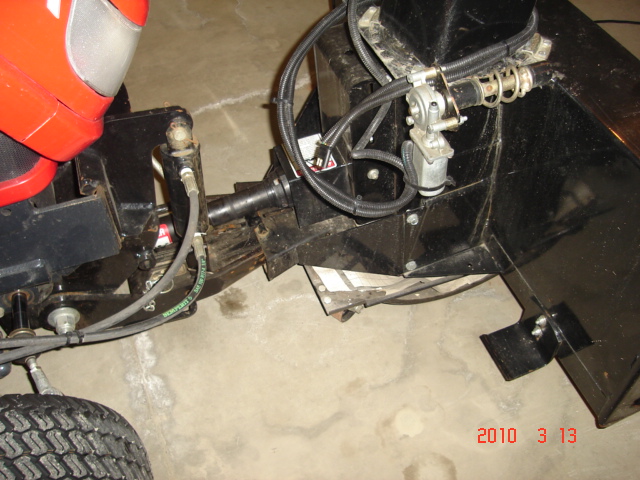

Just remove the 4' driveshaft from under the tractor, as was mentioned, by pulling on the ring at the rear to release the quick-connection, slide entire shaft forward (toward sub-frame), drop the rear away from the transmission, then slide (rearward) off the sub frame.

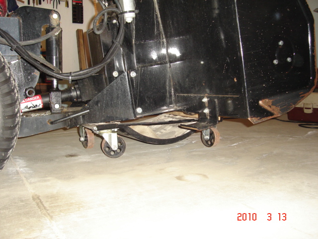

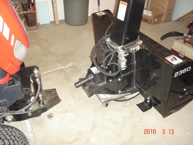

The blower will release from the sub-frame shoe by removing the linch pin, then the locking lever. I find it much easier to handle by removing the sub-frame and blower as separate pieces- together, thy're really heavy.
A flat, 4-wheel dolly for both the blower and the sub-frame will also make it much easier!
