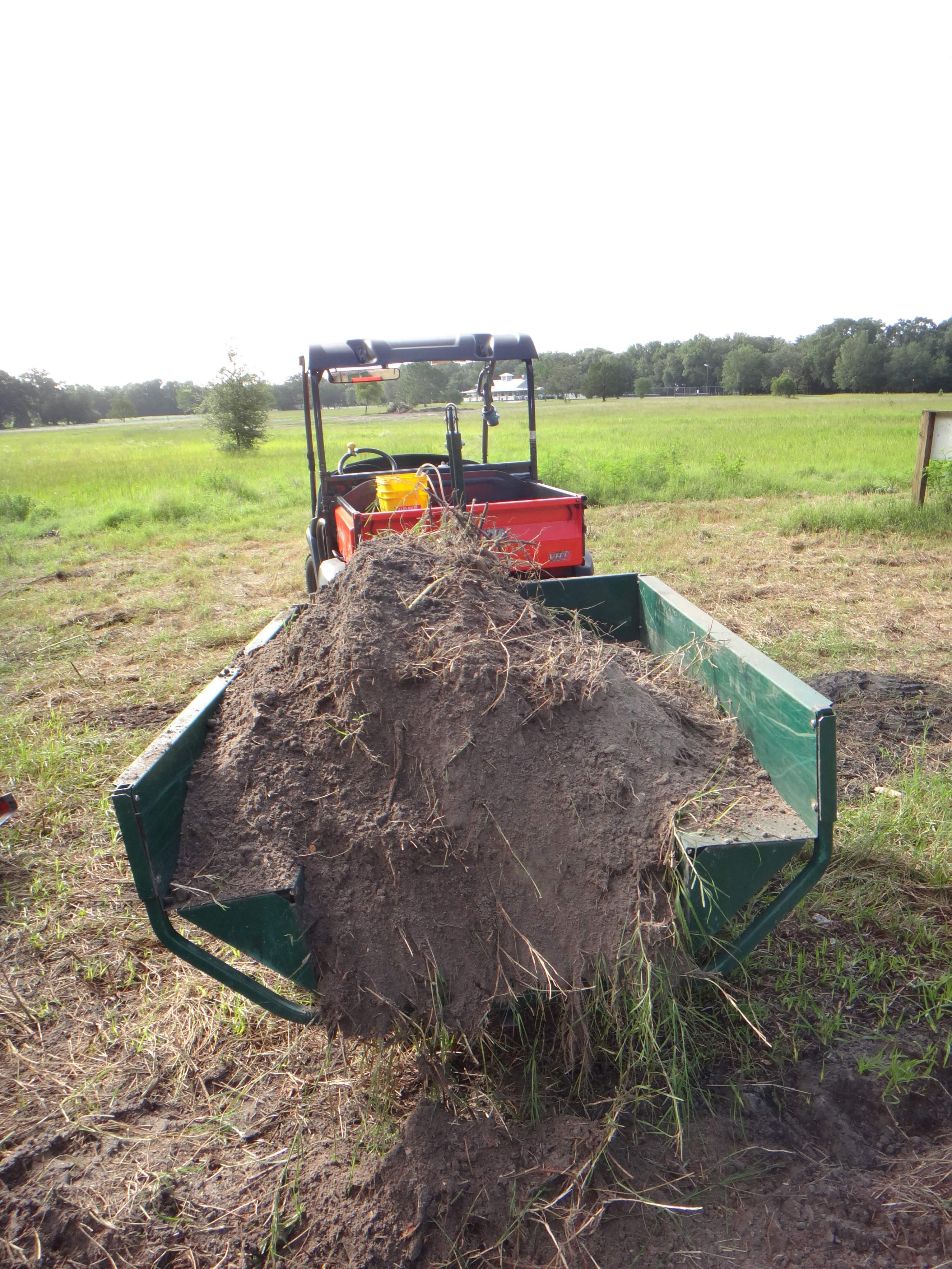

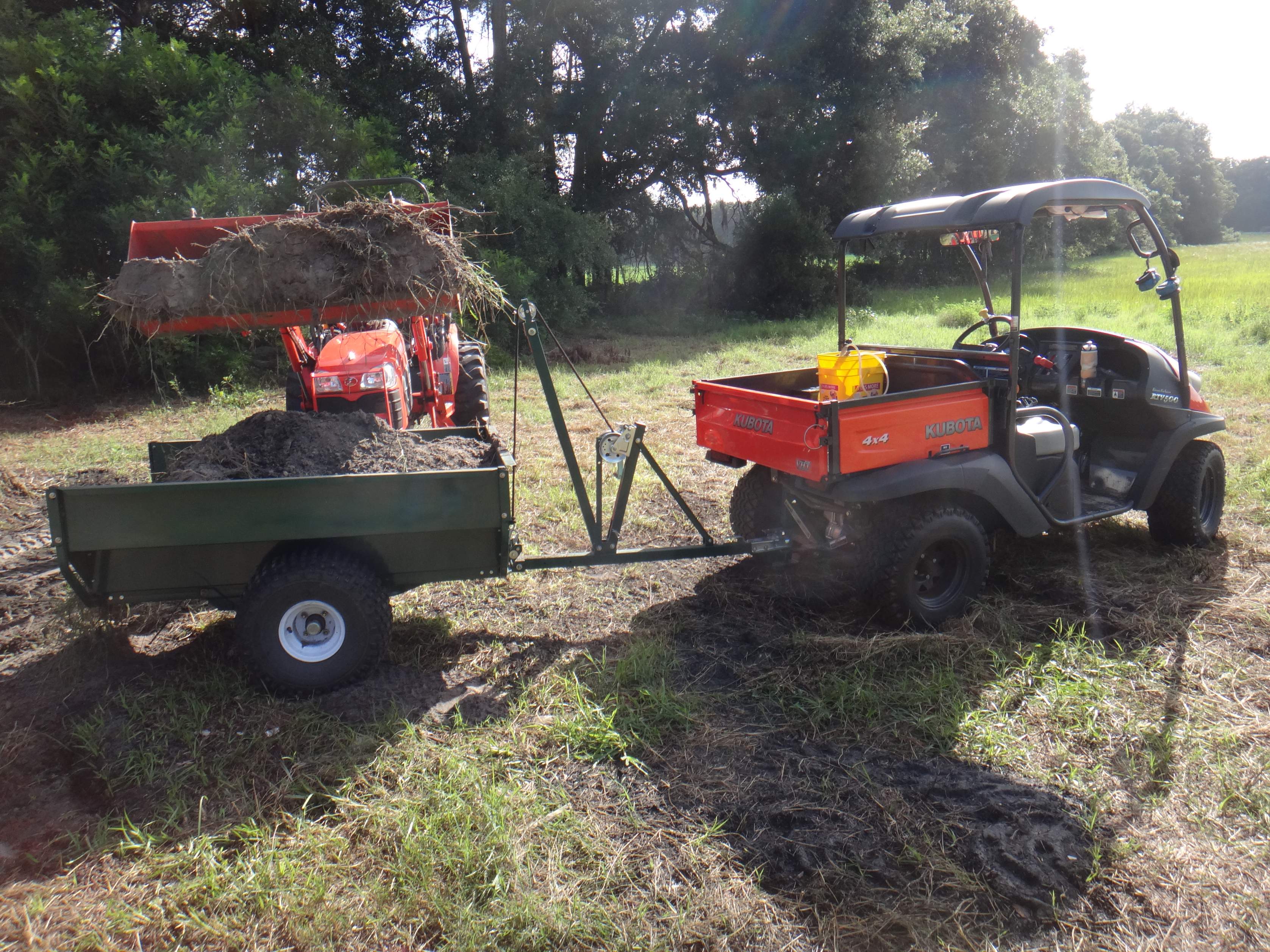

Geez, for one basement I would get a solid Tooth Bar for the FEL bucket and have at it.
Is your Box Blade heavy enough to do good work?
Maybe all you need is a small dumping trailer to haul spoil.
