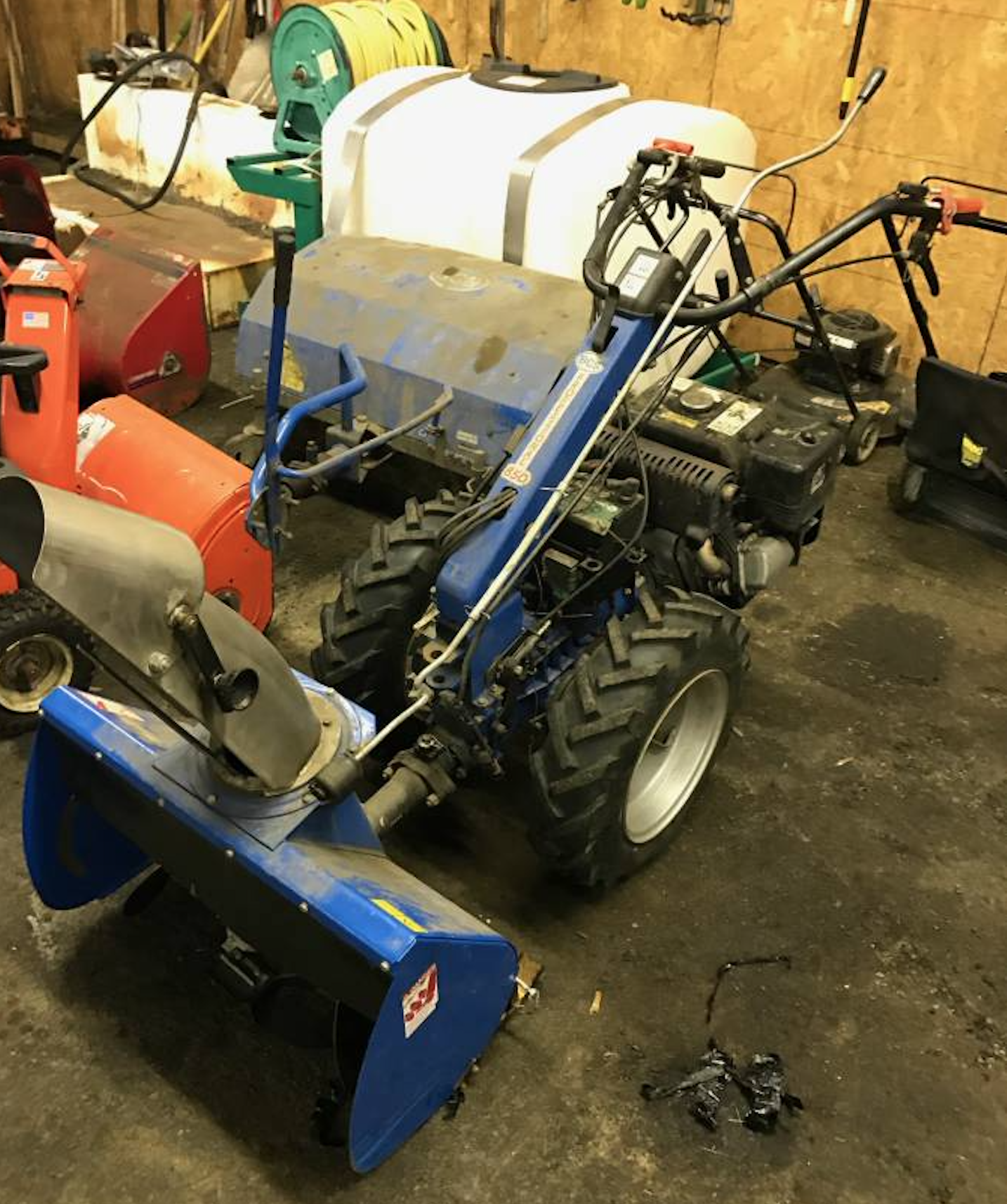

Thanks for the post.
Today we agreed upon $2,300 if I take a look at it and it's all in great operating condition. I will be seeing it this weekend.
Here are some photos of it.
