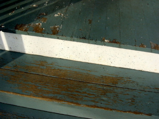

Can anyone give me some better ideas on how to stop this from happening? Ive painted these steps three or four times now and the problem keeps coming back. The problem is that the paint keeps coming up after the rain.
I sanded them, them primed them with Zinsser oil-based primer then put on two coats of Benjamin Moore Porch paint with the Epoxy hardener in it. When it rains, the paint bubbles up from underneath, then it's gone. Happens over and over.
Steps are pine; porch flooring is mohogany.

<font color="blue"> When it rains, the paint bubbles up from underneath, </font>
Can you get to the underside of the boards and paint/seal the bottom? That's where the mositure is coming from. Anything short of sealing the bottom of the boards wont solve the problem. /forums/images/graemlins/frown.gif

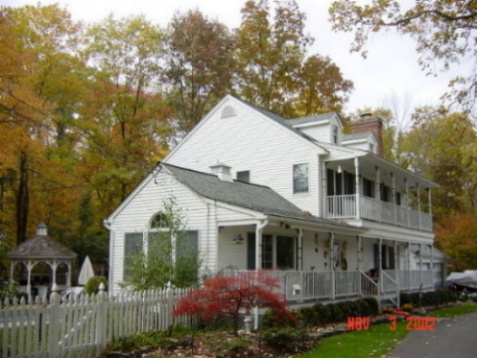

This is a picture of the whole house...
As you can see, I have a lot of porch wood to take care of...

If you decide to keep the pine steps, I would use a good oil based primer and prime all six sides of the board(s). I'd even finish coat them, if there weren't too many steps.

XIM is good stuff. It's pretty "hot" and it can give you trouble trying to get a smoothe finish on a wide surface. I don't know if the "trex" people will give you nod on painting it but you can ask. If you go to Trex you will have to add bracing to the stairs as Trex does not have a lot of linear strength and requires 12" centers on a deck project. I think your problem is moisture in the boards and that they are never really getting dry before you paint them. They may have absorbed something off of the ground as well. Are you using a lot of snow melt, fertilizer, lime, etc? Salts in the wood will repell the paint. I would try new boards that I can cut-dry-prime & paint (all sides) before mounting them on the stair risers.
