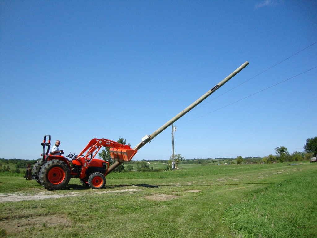

I have an ls r4041 does anyone have any suggestions on how to secure an 8x8x18 long wood post to the bucket, or grapples? I am building an entry gate and the tractor would be a huge help to raise and lower the post in vertical position. These are decorative posts so I cant bang them up
Thanks for the help!

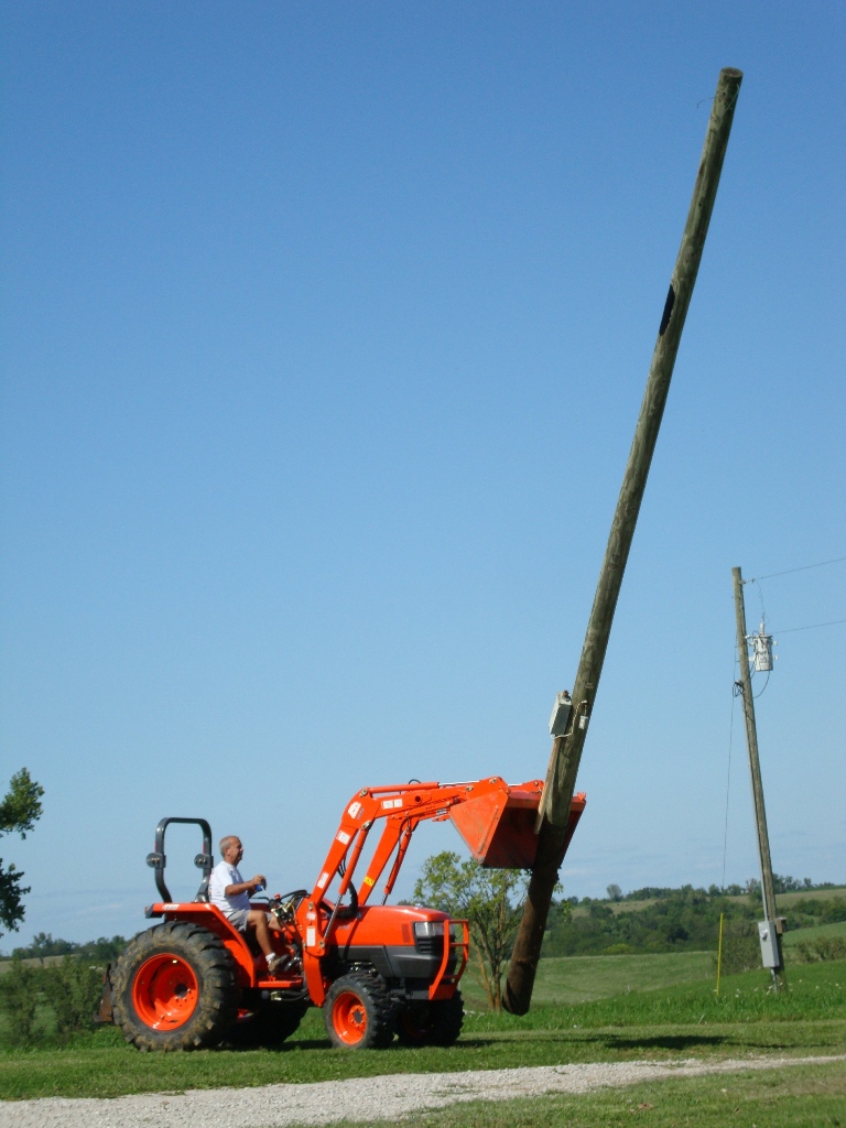

Lay the pole on the ground in front of the tractor in the same direction as the tractor. Roll the bucket completely forward and set it on the pole, leaving enough pole under the tractor or below the cutting edge of the bucket to allow the pole to be set in the bottom of the hole before the bucket edge hits the ground. A chain holding the top of the pole and a chain holding the bottom. Just don't leave too much pole under the bucket or you'll have trouble getting it picked up.

Nice!!!!!!! Thanks for the technique, very cool. I just had some more projects pop into my head!

I have various jibs that I use to extend the reach of a loader. Even then, some of my projects have been kind of scary, like those pictures in this thread!
Sometimes I read through accident/fatality reports. Amazing how many of them all centre around a farmer and a chain!

OVR.. that is a fine idea.. thanks!
this is an entry gate, posts cant get banged up.. i guess i can put another piece of wood between cutting edge of buck and post, same on back side of post where chain goes around.

Been there, done that...that way...1 success, 2 failures
I had 3 wood poles to stick into the ground, holes dug...just needed to get them vertical and drop into the hole. I gotta warn you that there is a lot of things that can go wrong doing this. In my case, two of the 3 poles were too heavy for me to do it...it's amazing how many ways that a pole can slide sideways, cause hydraulics to reach their limit, etc....
Be sure to chain somehow so pole does not overbalance and come back on the tractor hood. Plenty of rear weight.
Be careful out there doing this...lots of leverage there.
