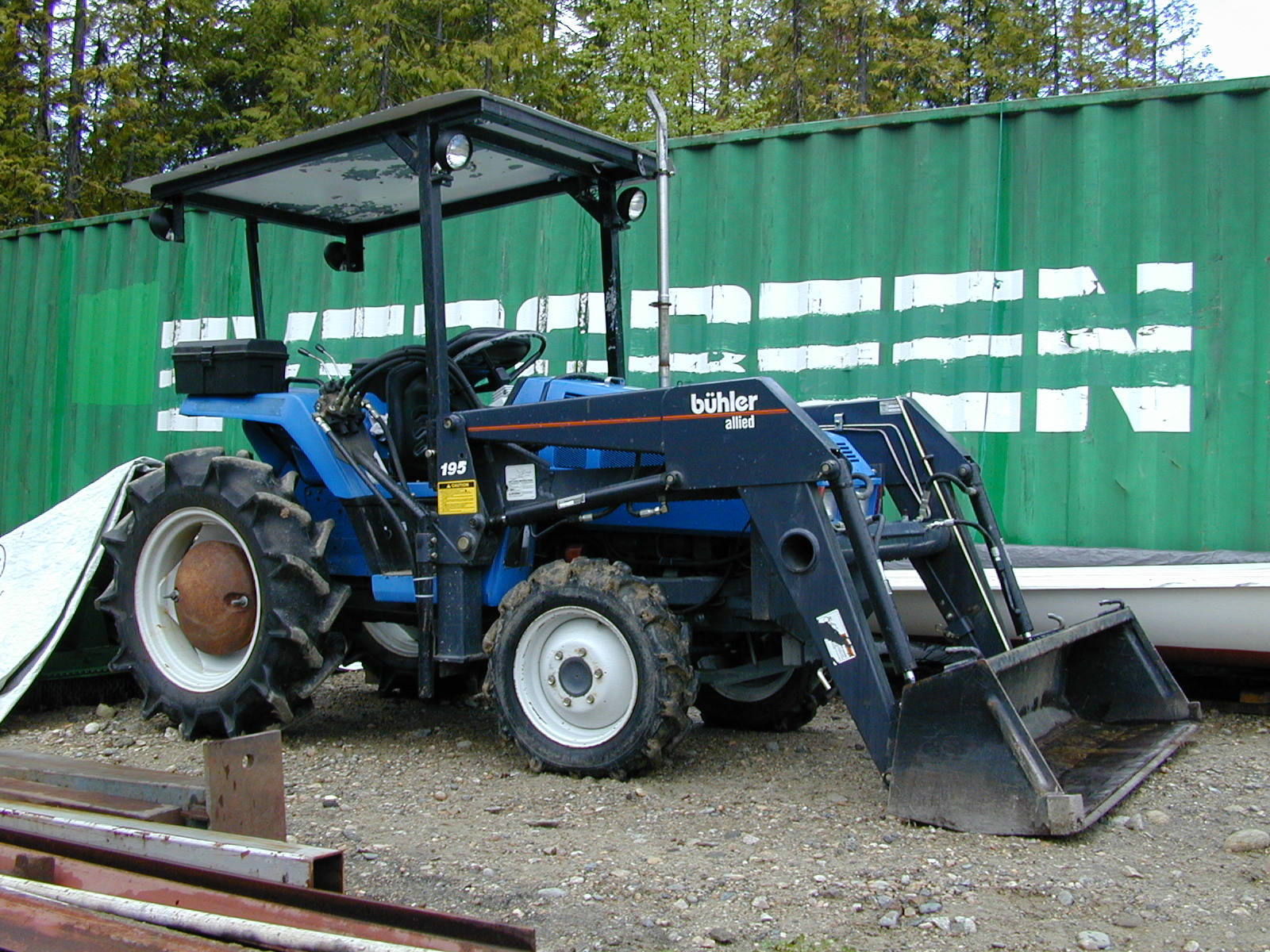

I also think you have a TU220 Landhope. If you have a step through configuration (flat floor panel from one side to the other) under your feet and a bit of a lower front shroud with plexiglass windows, that would be the model. Parts are available for the TU series from a few sources on this site, but they are not the easiest tractors to source for. Unless you have unusual parts needs, common items are available. Attached is a picture of a TU205F, stripped of the side engine covers and decals missing.

Often none of them fit perfectly. Koyker in South Dakota said they had one for my TA 247 and that it would fit others as well. I ended up doing some re-drilling, Plasma cutting etc. The oil drain was blocked and the tires would rub when turned way left or right. I had to trim the framework a little with the plasma.If you are a little handy and have some patience, Give them a try if they are still in business. I think mine was a Koyker 150. best $1500 I ever spent. They had a list of Iseki's that would bolt up and another that require a little mod.
