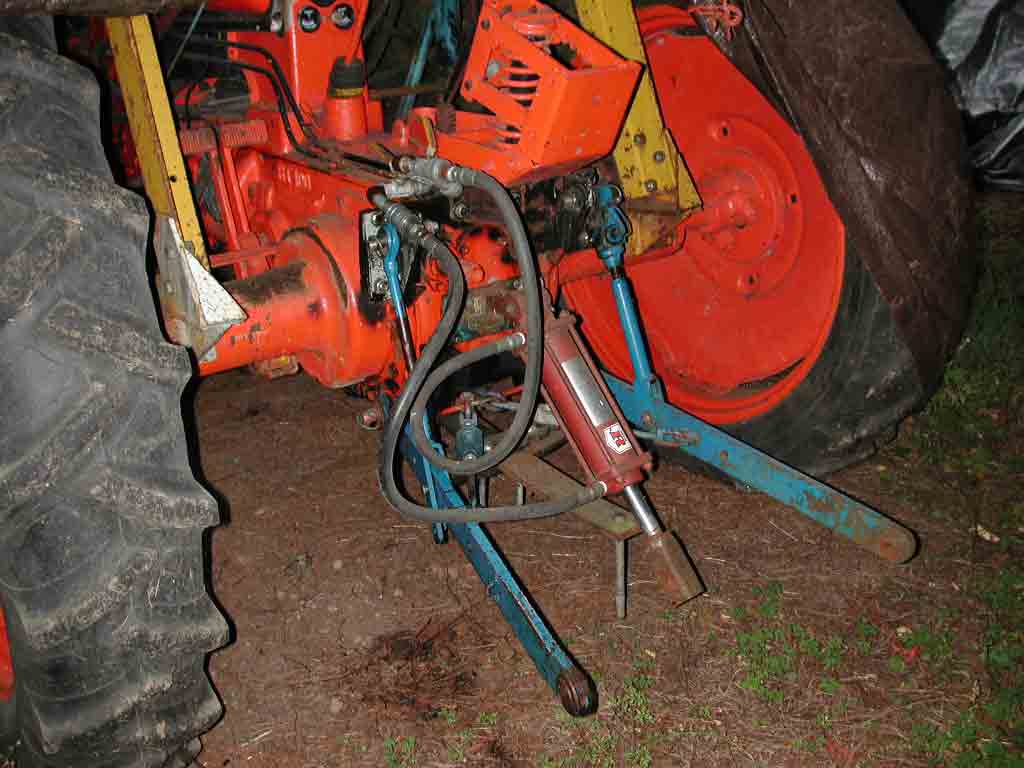

I built a three point for my farm tractor using the belly lift hydraulics which have a center float position. That sounds like the type of valve you may have. I put ball valves in the lines to the 3pt top cylinder. I lift the impliment to the height I want and then close the valve to hold it there. Not the most elegant set-up, but it did not cost me anything and works well...
