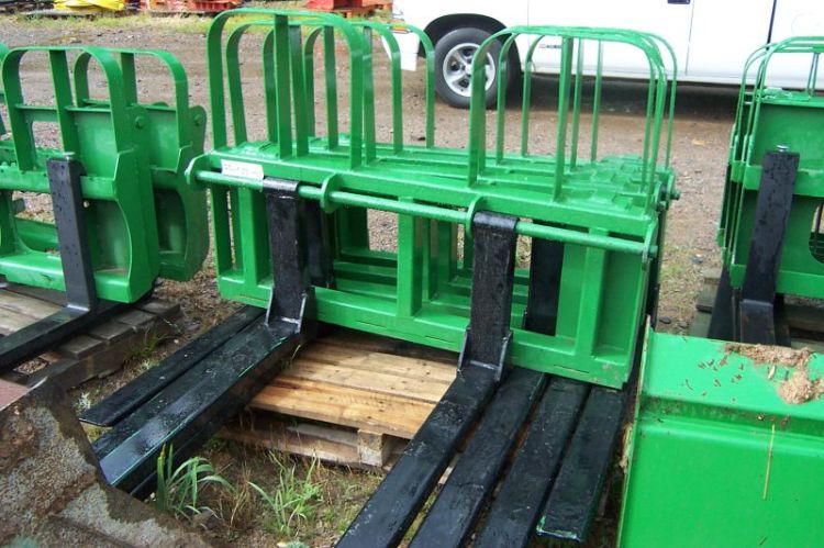

When at my Deere Dealer picking up some parts, I saw these in the yard & took a pic. There are 2 styles, one that the fork slides sideways on a round tube & the other that the fork slides sideways & locks into notches. I can probably get you some part numbers if you need.
