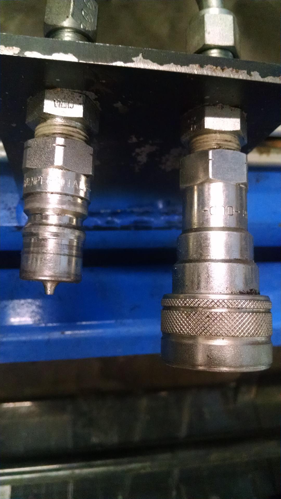

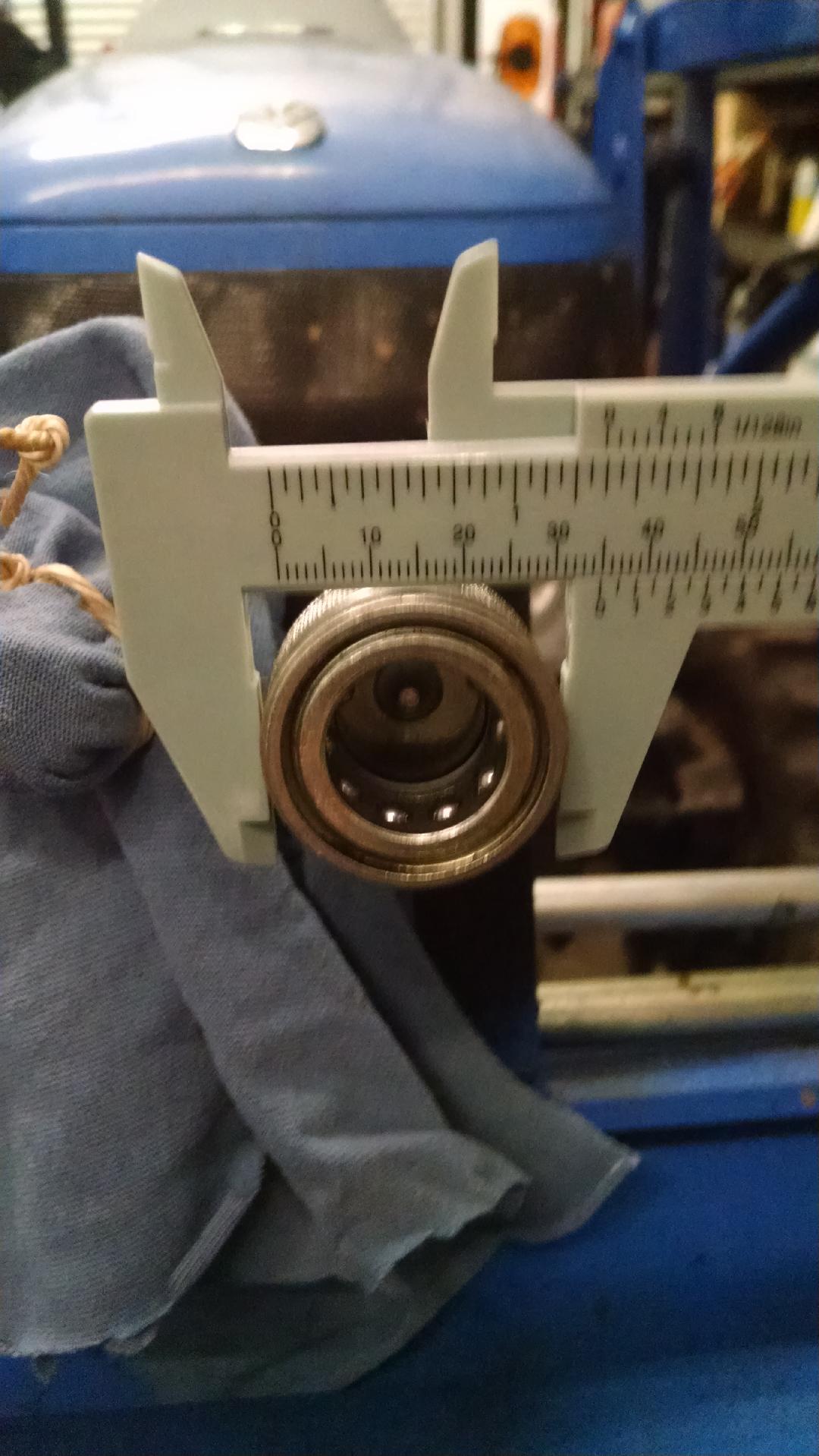

Hi folks. I am new the the forums here and still learning my way around, and thought that I would ask for some assistance.

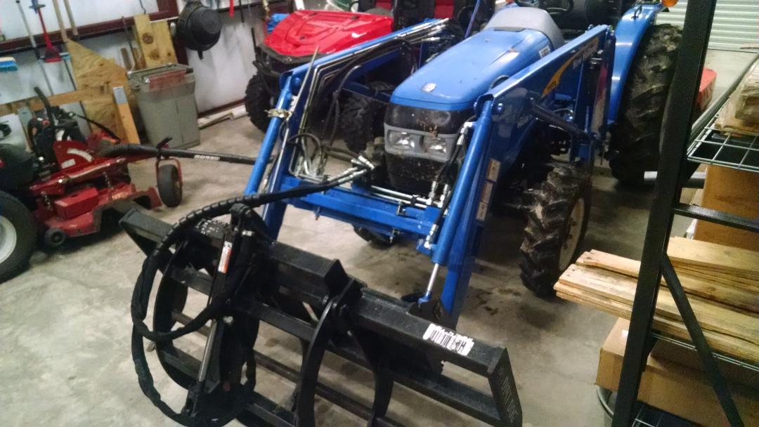

I have a NewHolland Workmaster 35 (used). The former owner put a 3rd function and a grapple on the front. When I use the bucket, I remove the grapple use the quick disconnects. So far, I have been using a rag and string to use as a dust cover.
I went to my local Napa store, and they sold me covers that are too big. The Napa guy was good enough to come to the forum (as a guest) and type in some search terms and I saw where some part numbers were listed for yellow, green and blue covers. I have spent the last hour looking for that, and obviously I dont know what I am doing....
I have attached a couple of photos for reference. I'd appreciate any help in finding a set of these. I have NewHolland, John Deere even a Mahindra dealer close by....and then there is the old standby Ebay and Amazon.
Thanks

Check with a local Parker Hose shop. They will have what you need.

Dust covers for the quick connects on a 7108 or 7308 New Holland loader will fit.

UPDATE. Well, when a dealer (in my case- New Holland) puts on a 3rd function (in my case for a grapple) they dont usually use an OEM Quick Coupler. They use whatever the parts guy ordered as long as the 3rd function attachment and gpm rates are met. In my case I found that the dealer used a "Faster Coupler" and did not supply the dust caps. So, after a long talk I did find a couple of old caps laying under a workbench at the dealer. They fit perfectly! They are 3/8". The part number written on the male is TMH-38. If I need to replace these, I will contact Faster and tell them I have a TMH-38 and need it's match for the other side.
I am posting this so that if others have the same issue, at least they have some place to start looking.

I’ll stand by my statement if your photo is that of the actual couplers you need covers for. There are multiple suppliers for any given style hydraulic coupler.

No need to become a point of contention, Sir. The coupler covers your suggested do not work, thus, my follow up stating what does fit my particular couplers and the explanation of why. Have a nice day!
