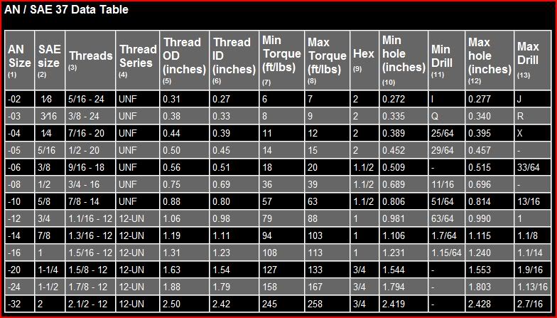

I need a couple new hoses for my Woods backhoe.
Woods part number 37961 which is a 1/4" hose with JIC6F fittings on either end.
Can someone tell me which size fitting thread this is ... based on the charts I have looked at .....,
Does the 6 mean a 3/8" thread?
Thanks,
Tim
   / Help with correct JIC fitting size #2
6 is the size (3/8" fitting) The actual thread is 9/16 fine thread.
   / Help with correct JIC fitting size #3
3/8" size as Brian wrote. AKA -06.
