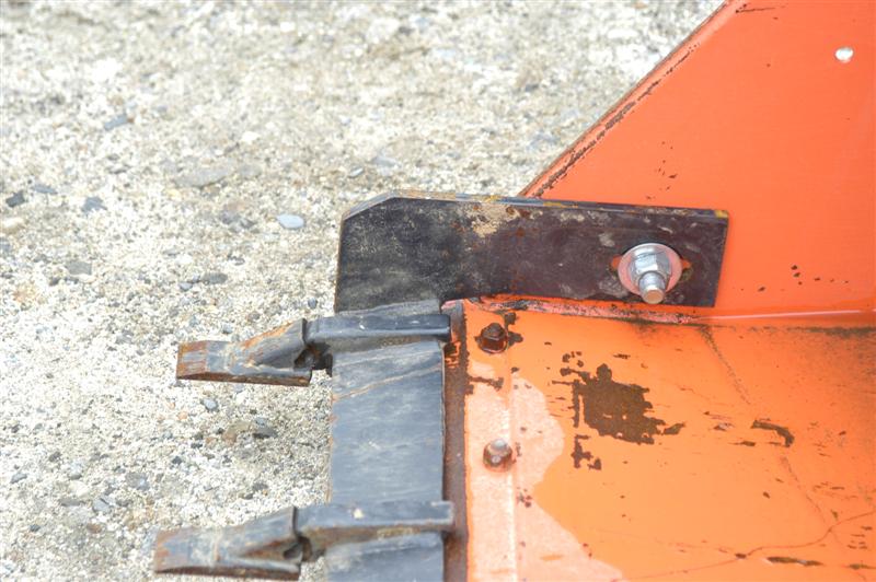

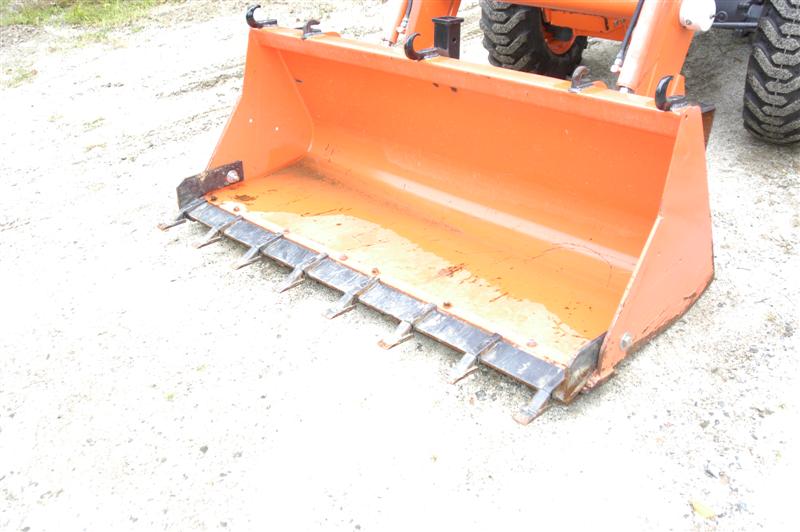

My Markham slides right over the edge of the standard 410 loader that I have. It's held in place by 2 large bolts through the sides of the loader. Easy to put on and to take off. I would NEVER want one welded in place. I only put it on when I need to do some serious digging, or to take up some asphalt paving (can slip it under the edges and lift it up; never could do it without a toothbar).

weldingisfun said:
Glad you made your choice. But, I have a Markham, it is a bolt-on and it takes about two minutes to remove. I don't know what you were shown as a Markham?
I called and talked to Markham Welding and at the time they did not make a toothbar that fit on a bolt-on cutting edge. I'd have loved to save the $$$ and buy the Markham, although I definitely have no complaints with the quality of the Woods.
From the Markham Website
****Our tooth bars will NOT work on a bucket with a bolt-on cutting edge.
