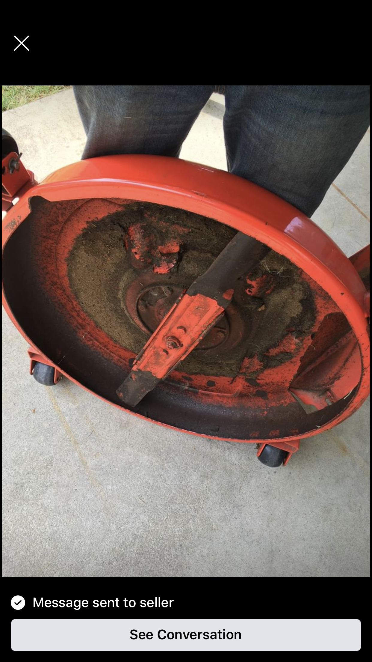

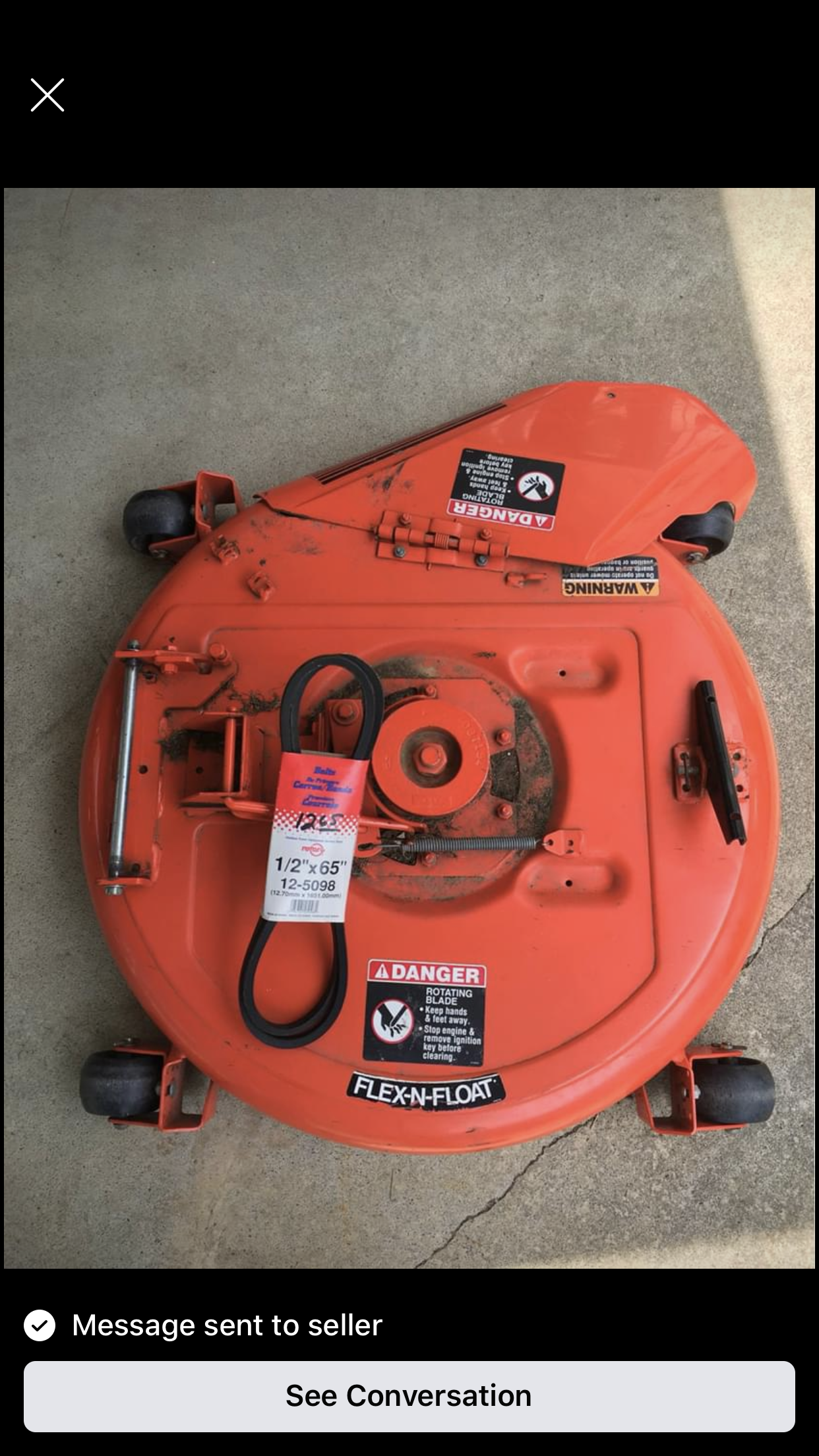

I am looking to tinker with an old Ariens single 28 inch blade mowing deck, converting into a FEL / backhoe mounted trimmer. I need help figuring out what type of hydraulic motor to use, and the specs. I would like to power the motor with either of my tractors, so we are looking at 7 to 10gpm at about 2500psi. In my mind, the blade would turn at about the same speed as a standard finish mower would at working tractor rpm. My thought was to use a love joy coupling from the motor to the spindle. I believe I will need a crossover valve as well, to keep from having issues with the abrupt stop of the hydraulics.

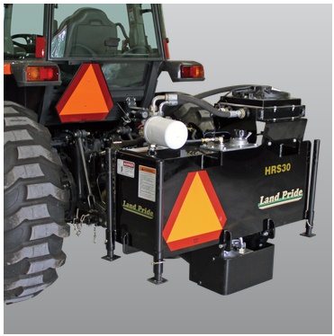

A blade tip speed of less than 19,000 feet per minute should be your goal for safety reasons.
Your precise tip speed can be determined by using the following equation: FPM = RPM x . 262 x Blade Diameter (inches).
The above equation yields an rpm of 2,500.
You claim to have 7 gpm @ 2,500 psi.
HHP=P*Q/1714, where P stands for pressure in pounds per square in., Q stands for flow rate in gallons per minute, and 1714 is a conversion factor necessary to yield HHP in terms of horsepower.
Hydraulic Horsepower = 2,500 psi * 7 gpm/1714
So you would have 10 horsepower available to drive a 28" lawnmower blade which is insufficient. Even if you say you have 10 gpm, it would not make much of a difference.
A hydraulic motor rotatating a blade at speed should be controlled with a motor spool hydraulic valve to avoid the abrupt stop you are concerned about.
Unlike a valve for hydraulic cylinders, a motor Spool Valve does not hold in its neutral position allowing the motor and rotating blade to coast to a stop.
Many tractor owners come up with ideas for utilizing their machine's hydraulic system.
In almost every instance the tractor does not have the capacity to power motors.
For the tractors ( large) that can drive hydraulic motors, many suffer from overheating of the hydraulic system as minimal to no cooling is incorporated into their design.
Companies like Landpride make pto driven hydraulic power packs equipped with a cooling fan. These units require 52 pto HP.
HRS3 Series Hydraulic Reservoir Systems | Land Pride
The Landpride system needs 52 pto horsepower and only manages to output 43 usable horsepower. It produces 25 gpm @3,000 psi
I will do the same Hydraulic Horse power calculation using Landpride's spec's
HHP=25 gpm*3,000 psi/1714
HHP=43 horsepower
I am sorry to pour cold water on your plans but best you know the reality before going too far and ending up completely frustrated.

I actually have a 20gpm 3000psi Erskine PTO power pack. My thought was to use the tractor hydraulics so I could mount the cutter on the loader or the hoe. That said, I believe I can accomplish what I want with using just the loader, with a cylinder to angle the cutter. As the power pack is designed to power things like a snowblower, I’m assuming when you shut off the PTO, the motor will coast to a stop with the PTO winding down? This would eliminate the need for a motor valve or crossover.
