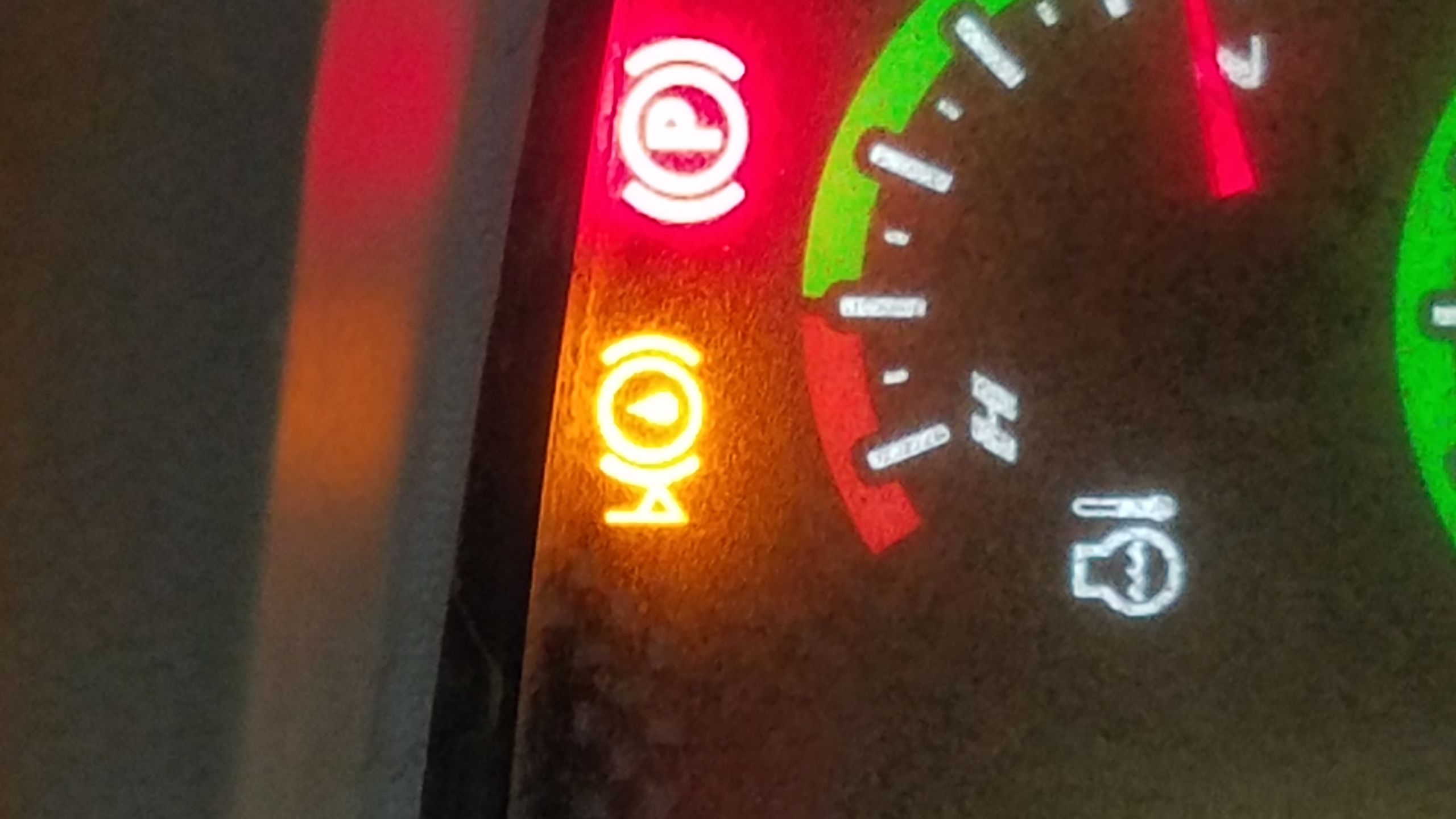

Does anyone know what this yellow caution symbol is on my console. It is not in the manual I got from the dealer and they are worthless. 20180804_155843.jpg

Well - - I tried downloading the OP manual for the 75C but Firefox says its an insecure site....... Not in YOUR manual and dealer has no idea. Call alternate dealership or regional service manager.
Maybe somebody will pop up who has a service manual that tells what the caution symbol is for.
Had a thought - - looked in my Kubota OP manual. In my OP manual that symbol indicates low oil pressure.
So....... check you engine oil level and does the symbol go out if engine is operated at rpms above idle.
Wouldn't hurt to check engine coolant level also.
Otherwise - sorry, no answers here.
   / Help with CASE 75C warning Light #3
Brake fluid level is low. That's what my NH t4.75 manual identifies it as.
   / Help with CASE 75C warning Light #4
Wow!!!! Talk about same symbol for differing systems. Hope Turbys answer solves the situation. Wonder why the 75C manual wouldn't identify that symbol.
   / Help with CASE 75C warning Light #5
My 75C manual also lists it as low brake fluid, which kind of makes since with the international symbol.

Thank you. I appreciate your help!
