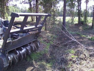

I rent a Bobcat with Forestry Cutter when I have the funds. The Bobcat worked great he first two rentals as it was new. But the last two times including this weekend it is running hot fast and I am getting little done.
I do everything that it calls for you to do (keep the top of the radiator clean, air filter clean, antifreeze). I wondered if it is the A/C that is getting it hot fast as the two A/C filters are extremely dirty as if someone washed them off and then used the Bobcat in dust.

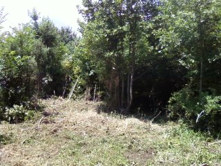

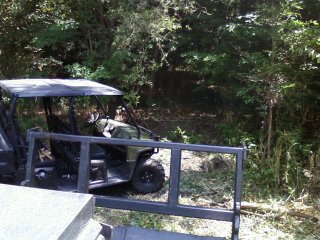

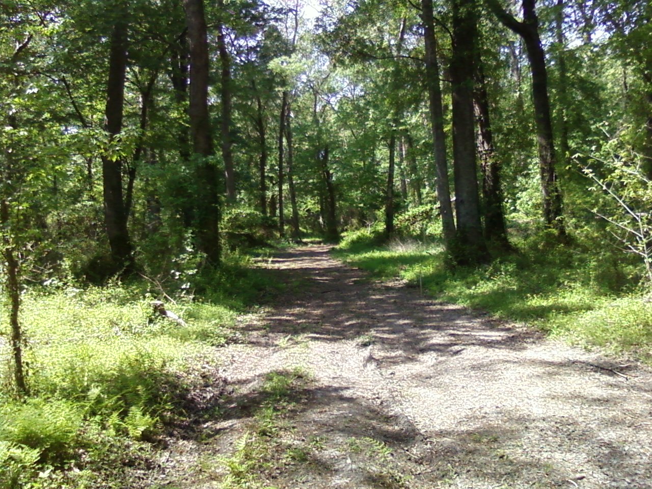

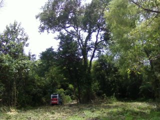

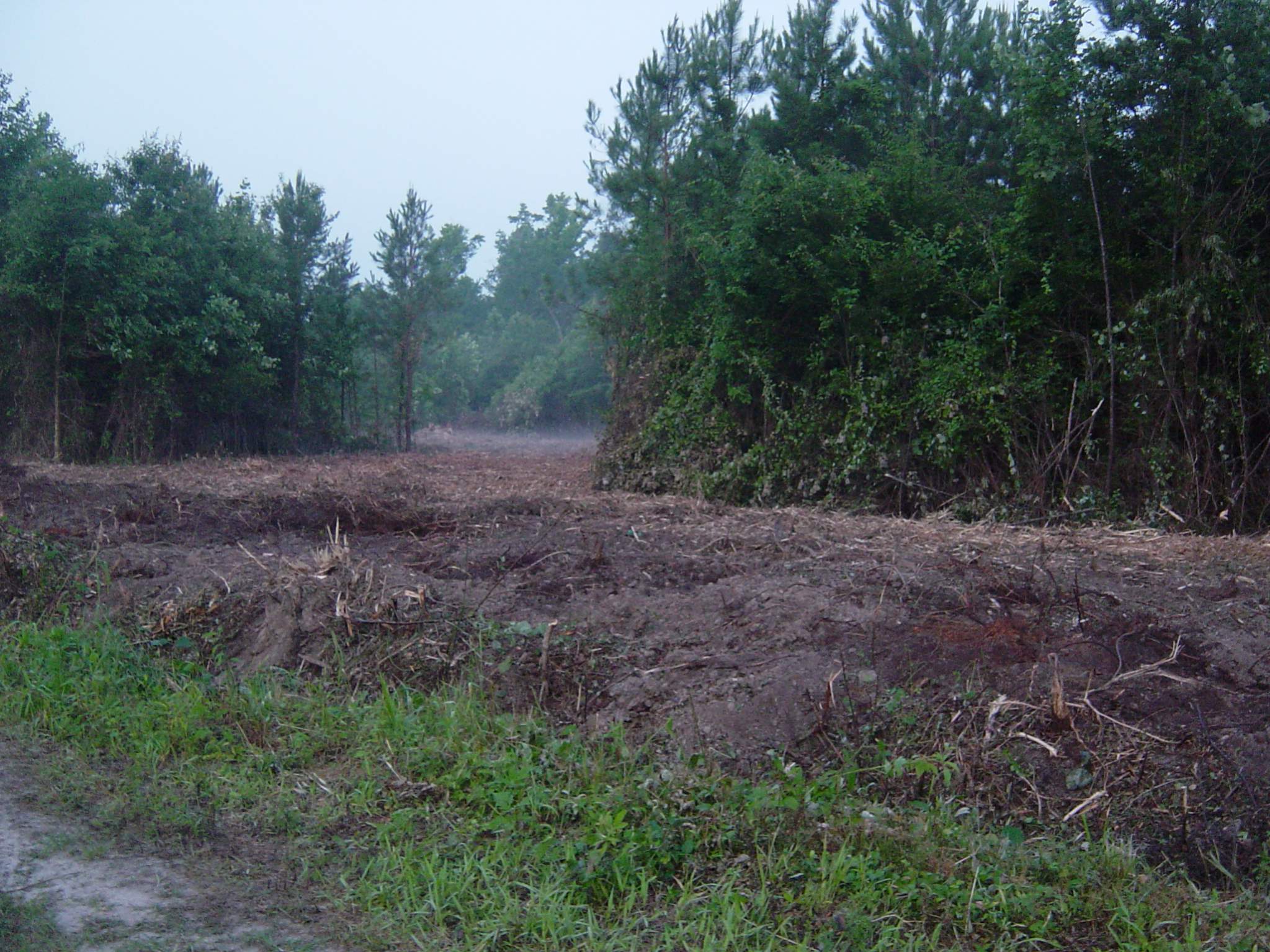

Here are a few photos with the cut areas and what some looked like before.
