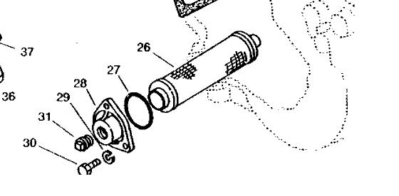

   / Help with bad sounding transmission #6
Mark,
I think the line comes into the transmission on the right side and has a single large bolt attaching it. The filter is behind the plate with 3 bolts, which is located on the left side, directly across from that line. I will try to attach a picture for Richard.
Rich

Thanks for the attachment. I was going to reply and ask but you beat me to it. I will look at it tonight. Did'nt have time yesterday. Is this normal wear and tear for this tractor? Could i be shifting the power-shift improperly?

I got to the filter with no problems. It looked dirty and i cleaned it up and let it dry. Is there an equivalent fluid to the JD303 that i can use? I can get the JD303 its just a little out of the way for me. I drained about 5 gallons of fluid. Is this too much fluid for a 1610d. I was looking at some other posts that said it's capacity was closer to 3.5 to 4 gallons.
