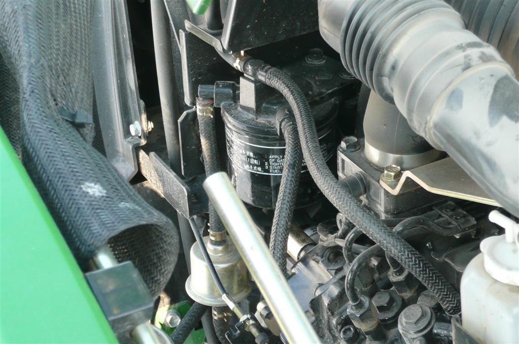

Ralph, sounds like your talking about the water seperator, the filter is in a black canister (looks like a oil filter) which is above the seperator. I will take a picture in the morning.

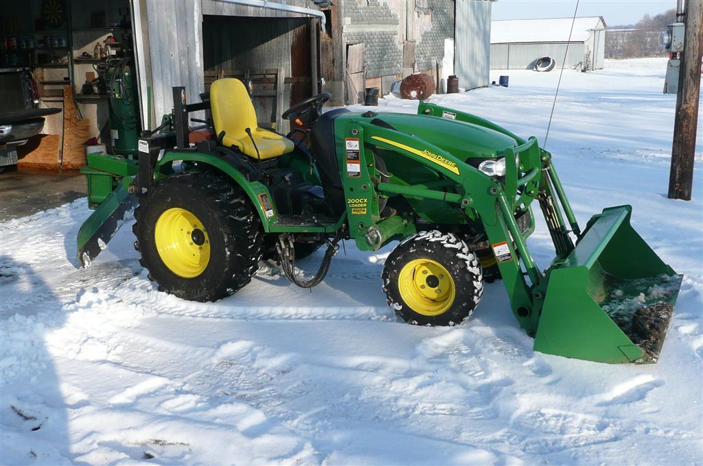

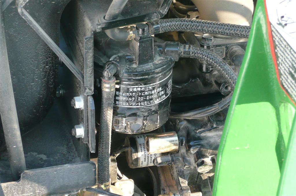

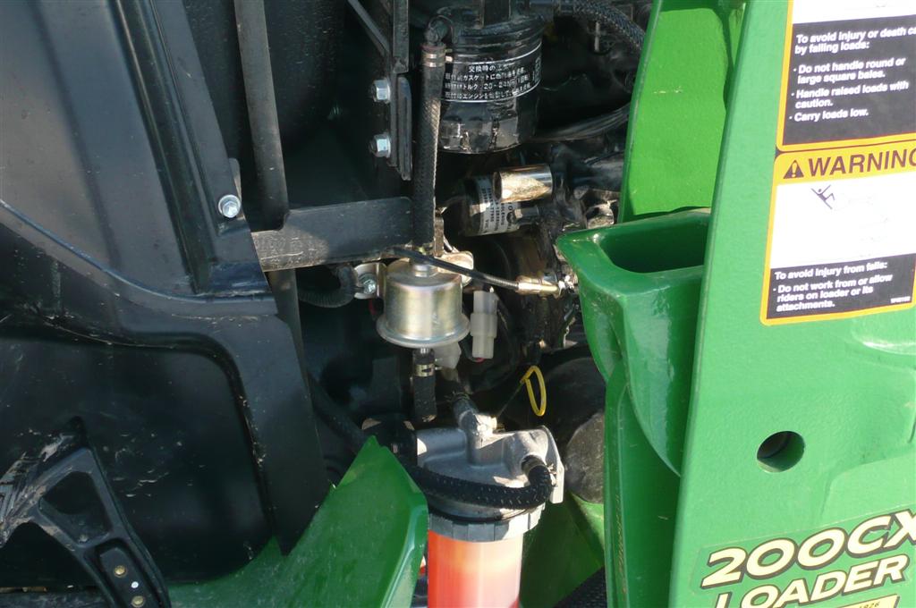

Here are some pictures of the little turkey. From what the dealer said remove the canister and the filter is in there and replace the filter and install the canister back on. As you can see it has some battle scars on it, and is winning now!

I've had that problem and I have a one word fix
strapwrench
a good one

Well--I took a look at the manual on-line and it looks like the filter is in the water separator--not in that black canister--are you sure it's in there?? (not trying to be a pain, sometimes the on-line manuals are different, and when I had a 2520 the filter was in that "glass" bowl).
   / Help with 2520 fuel filter change #8
here is a shot of what I read
   / Help with 2520 fuel filter change #9
There is a small paper cartridge filter element in the fuel water seperator and then the black spin on fuel filter. Do as MrJimi says and use a strap type filter wrench on the spin on filter and you should be able to remove it. If not you can always drive a Phillips Head Screw Driver thru it and use that for added leverage.

I bought a 3 finger wrench at NAPA to remove the oil filter on my 4010. Looks as though you could use it on the bottom of your black canister if a strap wrench won't move it. The 3 finger wrench accepts a 1/2" drive socket.
