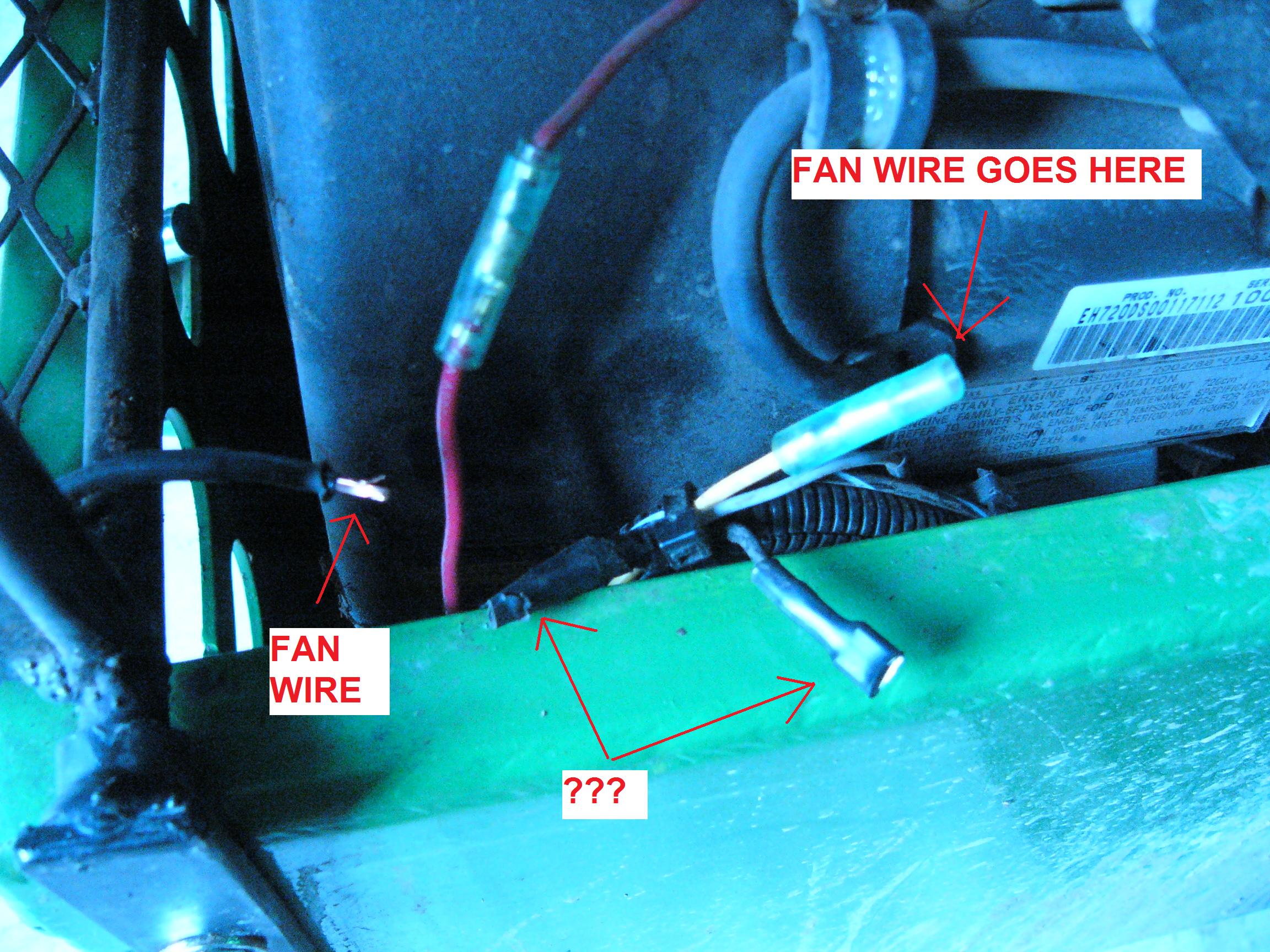

I was brush cutting in the woods, backed up and a large stick wedged up into the engine compartment and pulled apart some wires. The PT immediately stopped and I got nothing when I turned the key. After I got the stick removed, I saw that a connector had been pulled apart as well as a wire to the fan and perhaps another wire. Got the connector back together and it started and got it back to the garage. I know where the fan wire goes....I turned the key on and touched this wire to the connector and the fan started. THe problem is that it looks like there's an additional wire with a connector on it that I can't figure out where it goes. Maybe it goes to the taped wire in the picture. Anyone know if this wire is supposed to be connected to anything or is for diagnostic purposes? The picture shows arrows to the two wires in question (the one with a connector and one taped up). It sure doesn't look like the one with the connector pulled out of the one with the tape.

I have a few extra wires on my Kohler. Perhaps you have some on your Robin?
   / Help...wires on my 425 ripped by a stick #3
On my PT 422, in the back right corner there is a wire bundle (with the fan connector, ignition switch ground wire?) , which also had an extra connector which is wired to the pressure switch on the engine. I suspect that it is the same on your engine. Check for continuity with ground with the engine stopped (should be zero resistance) and running (should be infinite).
Apparently the robin engine comes with a wiring harness, but the wire from the pressure sensor is not used by Power Trac. That spare connector is now wired to a Sonalert alarm buzzer, which should be a stock arrangement, IMHO.

Tim, I did the same thing but also added a light. So at low oil pressure or engine stopped I get a Sona alert and a light on the dashboard. This wire was originally not connect on mine either. A 422 of course. You can trace this back to the engine mounted oil pressure sensor.

On the upper right side of the schematic is the oil pressure switch. Power Trac doesn't connect anything to this gray wire... their is an unused bullet socket connector in the aft right side of the engine compartment.
I ran a wire from this to the sonalert, and another wire from the ignition switch to through a cut-off switch to the sonalert. I put a warning lamp wired around the buzzer/switch, so the light will always glow even if the buzzer is cut-out.
The oil pressure switch is grounded when it sees no pressure, and is open-circuited when the engine is running.
