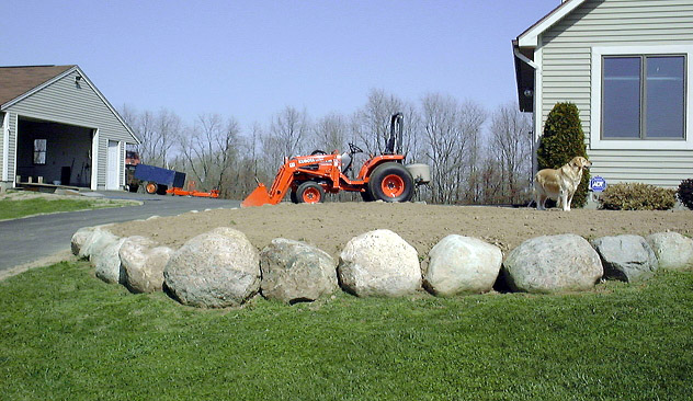

Thanks for all the replies. It gives me a lot to think about. To clarify - I don't plan on moving really large rocks, just a lot of 20 to 30 pound rocks(hundreds). I would like to have a tractor that will use implements I currently own and use with my 9N (box blade, angle blade, 5' brush hog, etc.).

Lil,
When you said rocks I thought you ment big rocks. Here is a photo of some I moved with my tractor. I don't think a bx would be able to handle some of the bigger ones in the photo. As for using the stuff that you are using now you might have to get something alittle bigger. Like the B2710.
