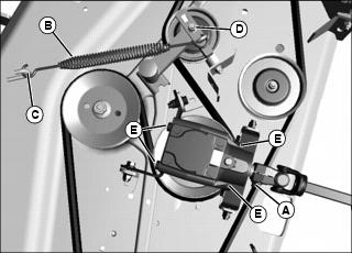

Mar 13, 2011 / help w/ belt on J.D 425 mower deck #1 N Nickbob54 New member Joined Mar 13, 2011 Messages 2 Tractor John Deere 425 Father-in-law passed away and we can't find manual for new belt placement on his John Deere 425. Can anyone assist me? Thanks.

Mar 13, 2011 / help w/ belt on J.D 425 mower deck #2 B beenthere Super Star Member Joined Aug 16, 2001 Messages 18,555 Location Southern Wisconsin, USA Tractor JD_4x2_Gator, JD_4300, JD_425, JD_455 AWS, added JD_455, JD_110, JD_X485(sold) :welcome: Sorry to hear about the FIL Not sure what is your question. Need the belt part no. ? Or need how to put it on the mower deck?

Mar 16, 2011 / help w/ belt on J.D 425 mower deck #3 B beenthere Super Star Member Joined Aug 16, 2001 Messages 18,555 Location Southern Wisconsin, USA Tractor JD_4x2_Gator, JD_4300, JD_425, JD_455 AWS, added JD_455, JD_110, JD_X485(sold) Here is a pic of the belt on deck. Unhook the spring at C to release the tension. More info needed, if this doesn't answer your question. Attachments 54_deck_belt.jpg 15.9 KB · Views: 9,457

Mar 16, 2011 / help w/ belt on J.D 425 mower deck Thread Starter #4 OP N Nickbob54 New member Joined Mar 13, 2011 Messages 2 Tractor John Deere 425 Awesome.. This exactly what we needed to get it going. Thanks so much for it. Have a great day and thanks again.. Nick
