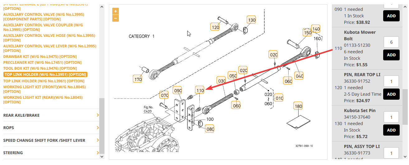

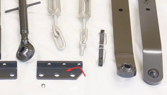

I've only used my 3PT for a Wood Chipper, and never got around to finding the missing bolts... I've only got 4\6 installed and now that I want to use plane and box blade, I don't want to risk ripping the 4 out when there should be 6.
I can only find the entire kit at messicks.
Does anyone know the bolt size\dimensions for the 3PT top link bracket on a Kubota M59?
(mine are of course red loc-tite in so would rather not heat and remove if I don't have to)
Hoping to figure out size, and have them here in bolt bin or go to town and grab them so I can continue my projects.

Found the parts themselves, but no dimension info :(
Anyone?

ColemanEquip Bolt --> Kubota Mower Bolt - 01133-51230
This site:
Shows this size: M12X1.25X30 mm #01133-51230
Anyone confirm this?
It's minimum 1hr drive to town for me so I'd like to be sure :)

Since you know the size and thread, go to the hardware store and get some in both lengths. Or just get the long ones and enough thick washers to shim if they bottom out.
   / HELP! Trying to operate today need bolt info
Thanks for that! Confirmed!!
Yep that was my 2nd plan :D Thank you for helping!
I of course have 8' wall of bolt bins but maybe only 10lbs of small metric :(
Update - Was able to get a 45mm variant and cut it to size, we are in business!!
