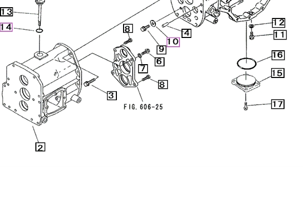

help to identify this part and why hydraulic fluid is flowing out it.
   / help to identify this part and why hydraulic fluid is flowing out it. #1
fourstate
Feb 26, 2024
2
2015 series mahindra
i cant find what this part is in the mahindra catalog it just shows a square hole where this goes on the center case. my haudralics drained out of it. like a plug was released, not under pressure.
it is on a 2015 gear series. thanks
   / help to identify this part and why hydraulic fluid is flowing out it. #2
Looks like they're missing some pages on the transmission control (gear shift lever) on the parts catalog for that exact tractor.
I went and checked the 2615, which I believe is the bigger brother of your tractor, HP wise anyway. And they do list the missing pages there.
Looks like you're missing the cap #13.
thanks for your help , do you have any ideas why it would come out?
