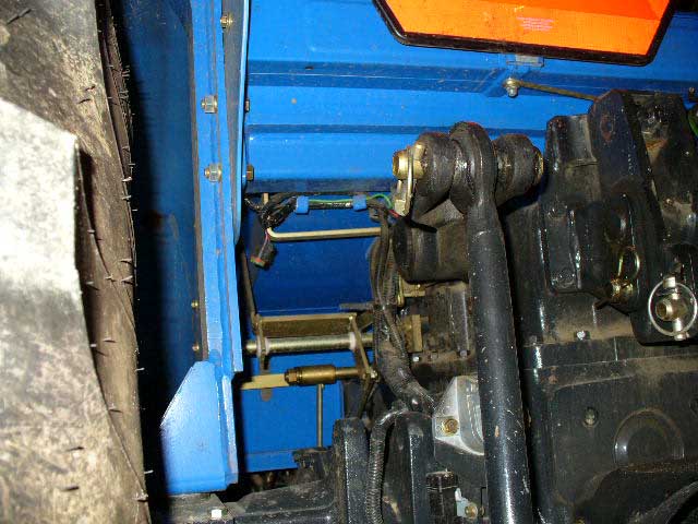

I want to add rear (and probably front) work lights to my tractor. In researching the wiring available I see on the fuse block listing there are 2 fuses having "rear work lights" in their description. The wiring schematic also shows rear work lights.
The "HELP" is I can't find where the actual wires/plugs are on the tractor that match up to the schematic or fuse block.
Any one been-there-done-that who could help w/a pointer or photo???
   / HELP - TC40DA Work Light wiring #2
The plug is under the seat platform where the wiring harness enters the ROPS. It's wrapped with a cable tie so it is a bit hard to find.
On my TC40D it was right behind the seat. On the DA mondel they moved it.
   / HELP - TC40DA Work Light wiring #3
Mine is a TC55DA but maybe the harness is in the same location. I made a pic were it was on mine, but now I have a cab on it and they used the pug. You don't see the plug on the pic, but it is in that area underneath that "toolbox" on the far left.
Hope that gives you an idea.

Thanks for the photo & description. I'll look @ the tractor tonight & see if it's in the same location on my 40DA.
   / HELP - TC40DA Work Light wiring #5
On my TC33DA the work light connector was located at the base of the ROPS on the top inside of the fender. So you may also want to look there if it is not under it. Also, it was turned back and wire tied to the wiring harness (not very obvious that it was there.) The connector is an automotive type 2 wire bullet connector available at Car Quest, etc.
Mount the switch to the ROPS in a Radio Shack work box and the wiring is short and simple.
