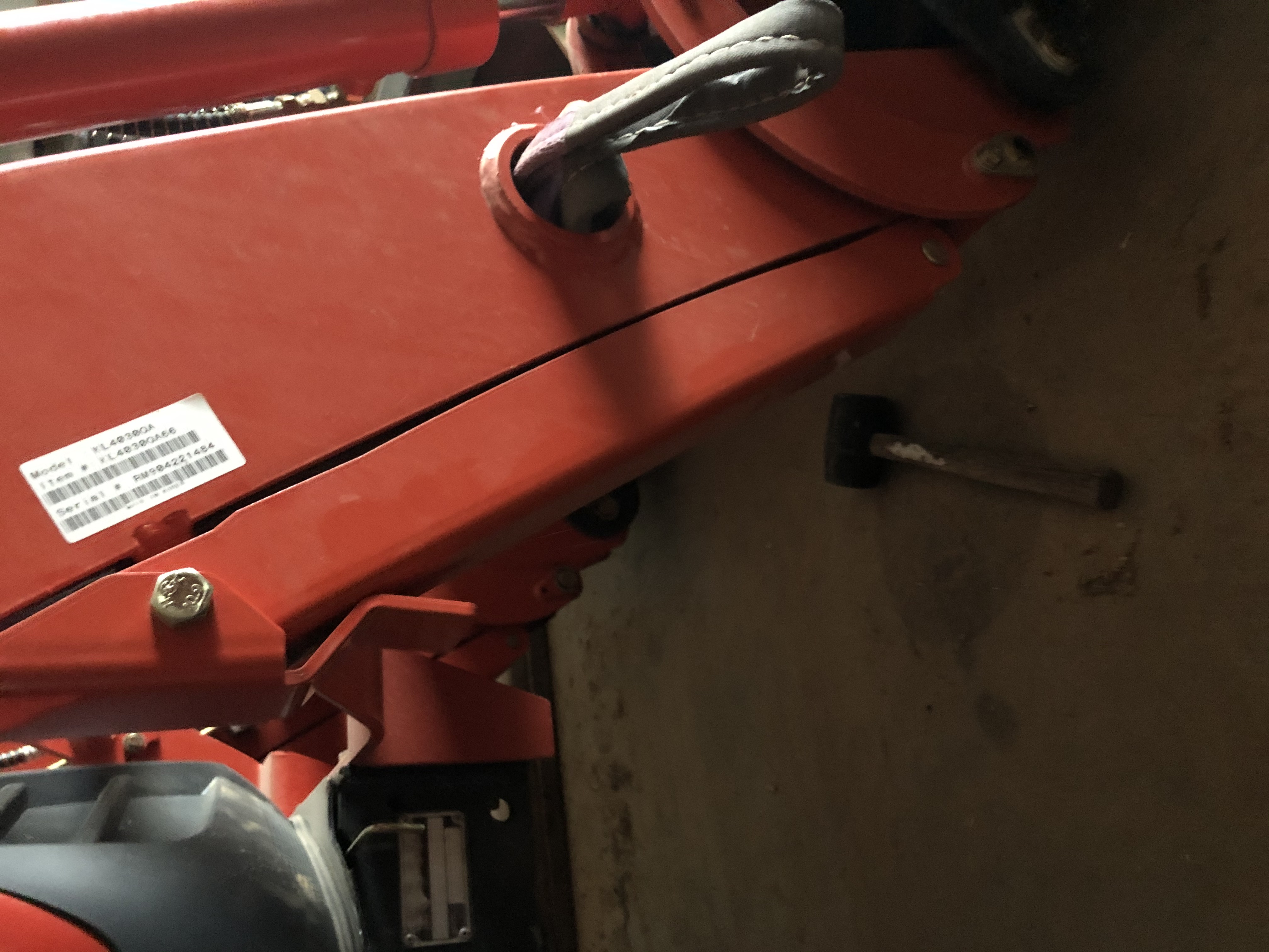

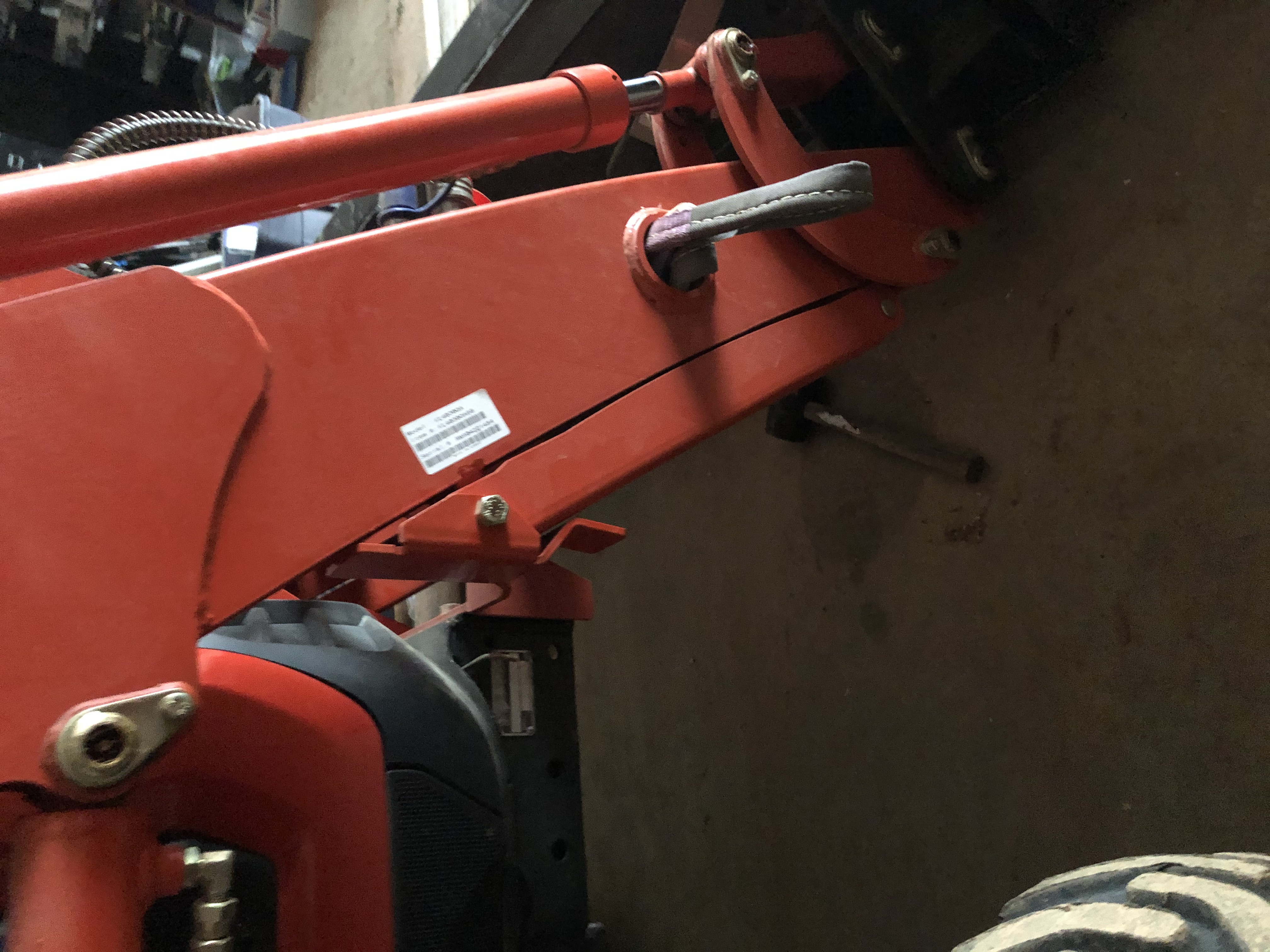

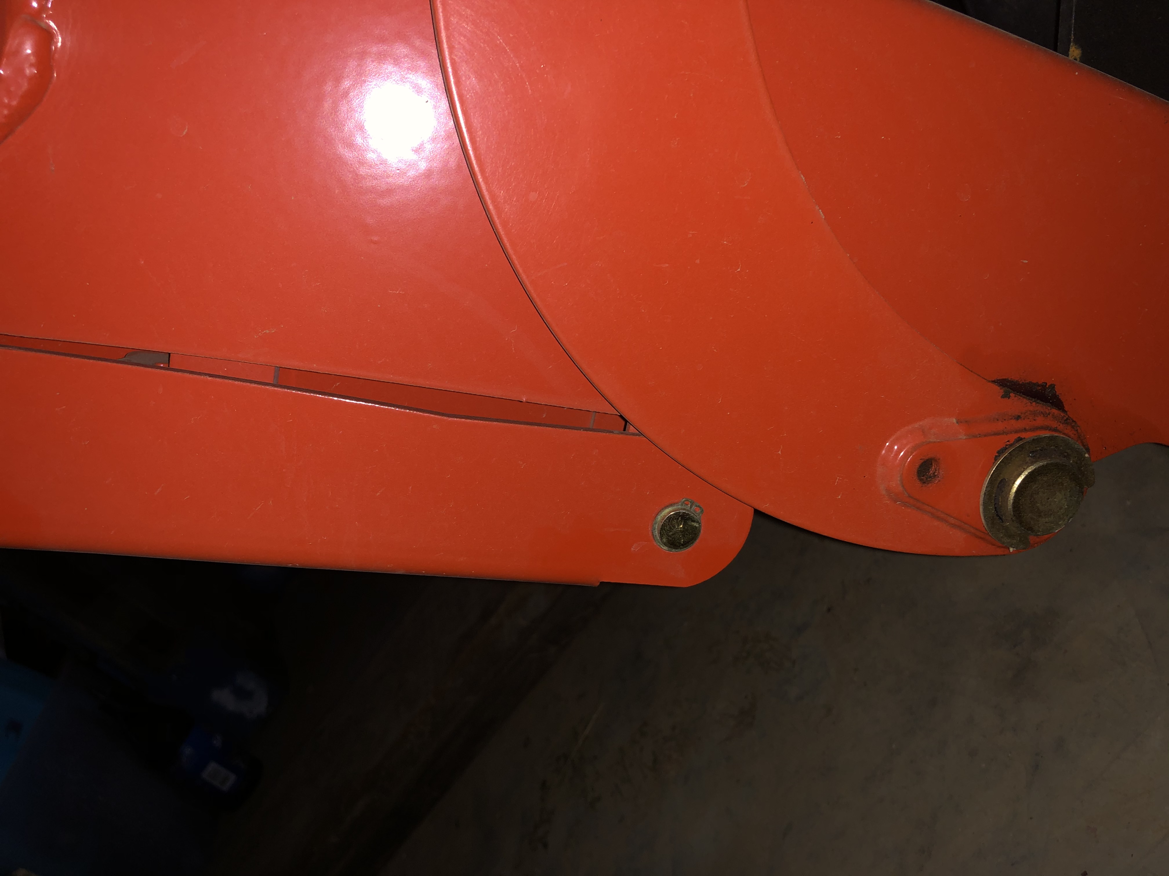

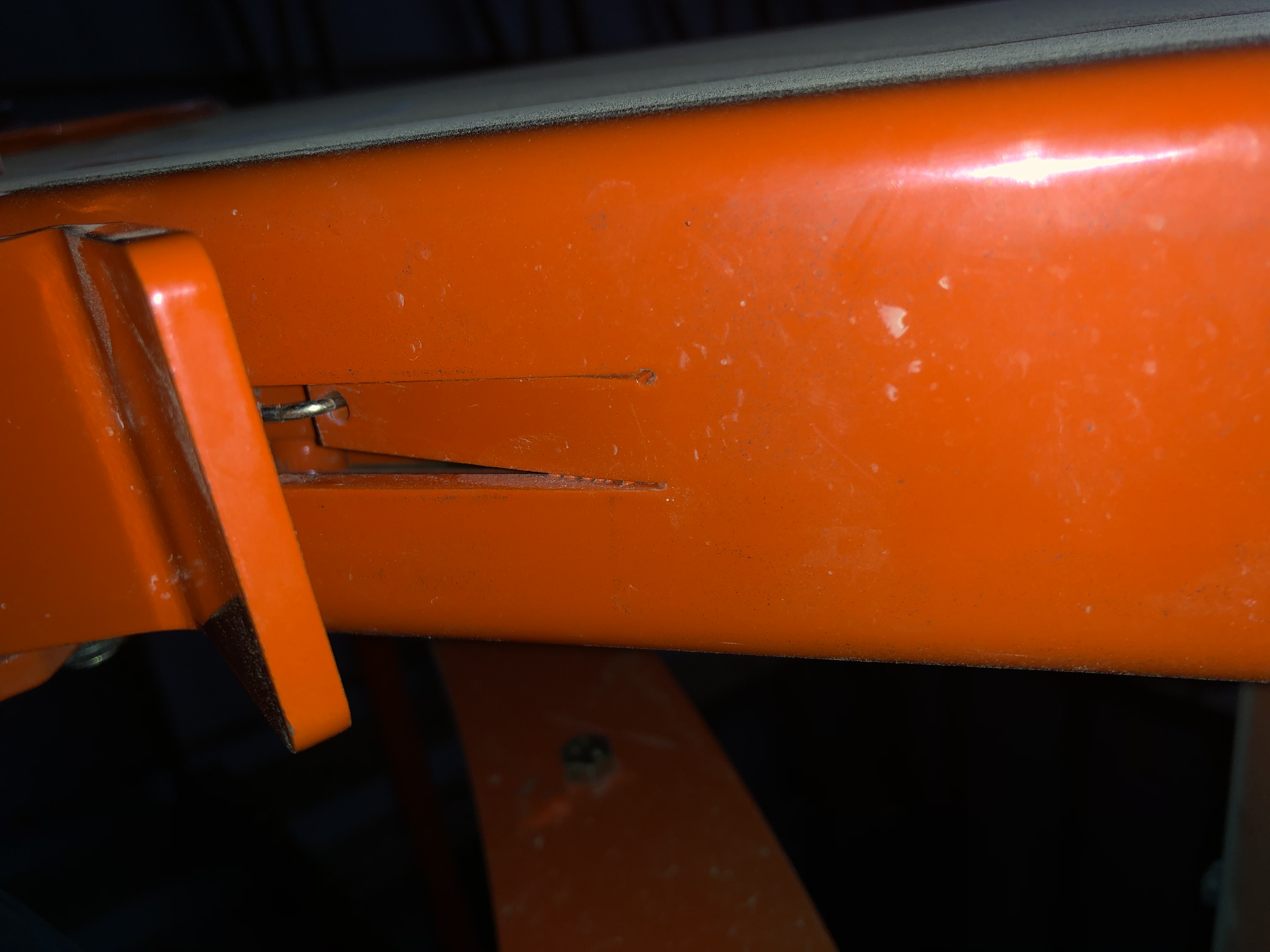

I HAVE NEVER REMOVED MY LOADER BUT WOULD LIKE TO. I have a ck 3510se with the kl4030 loader. in the manual it just says 'release the pin and keeper' for the parking stand. all I see is the bolt holding the foot of the parking stand on. there is a slot on the underside, but if I push a screw driver in, something seems to be spring loaded but I cannot for the life of me figure out how to deploy these parking stands LOL

ill go get pics now. was hoping someone had one and has done this before.

It appears to be a hairpin clip perhaps. Try to pull the clip. It may come out to release the stand or pulling may release the stand. You could also check You Tube for videos.
   / HELP! super dumb loader removal question
only vid I could find he just easily slid upwards.(4020 loader) these won't do that (4030 loader). I removed a cir clip and pulled a pin out of the bottom of the leg and the leg came off. but I thought it was supposed to be tool-less??. dumb design if I have to carry cir clip pliers and remove the leg completely and then reinstall it. The hole for that pin is round, so I don't think it will slide in any direction. in the slot was just a spring for the foot articulation. super weird. if anyone has the same loader I would be curious if the pinhole should be elongated or something.
   / HELP! super dumb loader removal question #8
The parking stands are spring loaded on the locks. Pull up on the parking stand foot to unlock them from the loader arms. When I remove my loader, I lower the parking stands & put the locking arm in the 3rd notch.

man, when I pulled every which way it never budged, but maybe because its new and hasn't been done yet. I will try that again. thanks for letting me know.
   / HELP! super dumb loader removal question #10
Yes, they will just pop down. You can use a small pry bar at the top by the foot. Once you do it, it will be easier thereafter. They stay up pretty tight so that they do not come down when operating the tractor / loader.
