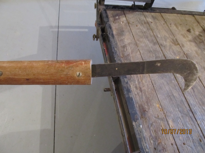

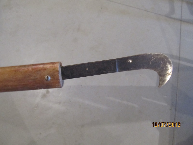

Well, I've been there and done that both with hose and wire. You're stuck just digging it out with a sharp knife and patience.
Here's a tool I made that makes life a lot easier when these things happen.

I can definitely see how that tool would be a big help. It is a lot of cutting, 'digging' and pulling.
