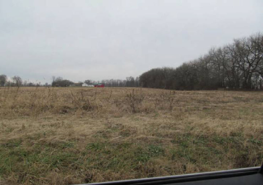

Hello - the forum has been super helpful with some of my last posts, and I've been scouring old posts from others asking questions on different models and brands, which has been great. But I need help with my specific needs...
I purchased 3.41 acres we are building a home on that is old farm land that has very gentle rolling hills (see pic attached). Last crop looked to be soybeans, and now it's just been a year or two of overgrowth that has been bushhogged when needed. My purpose for the tractor would be:
First 1-2 months of moving in:
  1. Bush hog any growth down - 40ft around the house will have already received a final grade, so this would be the rest of the land
  2. Till and turnover the soil to break up the remaining vegetation
  3. Box grade and seed/fertilize with some kind of grass seed
Ongoing:
  1. Overseeding, fertilize and mow
  2. Mulching and pulling a small landscape trailer around
  3. Snow plow the drive in winter
  4. Small hole digging for landscape - nothing major
I have decided I'm going to buy a 25HP tractor. The question is, I don't know whether I really need the compact model vs. the subcompact for my needs. People tell me the subcompact will get the same work done, but may be just a bit slower...my question is, how much slower (a few hours, an extra day, etc.)?? Do I really need the compact longer-term? I could also rent or borrow from a friend a tractor for a week to do the initial work on the land, and then use the subcompact longer term.
I'm looking at Mahindra, Kioti, and LS, but LS is pulling to the front, so for sake of conversation let's use the MT 125 ($12,900) vs. XJ 2025 ($14,900). I feel like I could save the $2K here, but I keep reading people wish they went bigger...I just don't know that I really need it. Thoughts?

For your tasks I would go with a 25 H.P.compact.More weight,power,traction and ground clearance.Buy once it is cheaper in the long run.
   / Help selecting either a subcompact or compact 25HP tractor? #3
The deciding factor for me was that the 2025 could not have both the BH and the MMM installed at the same time. I don't plan on mowing with the full BH mounted, but I didn't want to have to remove the subframe.

Here is a good video addressing 25-hp subcompacts with 9" ground clearance vs the lightest 25-hp compact tractors with 12" ground clearance:
Kubota BX Series VS. B Series - YouTube
Compact tractors with 24 horsepower range to 2,900 pounds bare tractor weight.
Subcompact tractors have two-range HST transmissions.
Compact tractors have three-range HST transmissions.
Selling a used tractor is easy. Selling multiple light implements in order to buy heavier, wider implements for a new, heavier tractor requires a lot of time. Depreciation on implements is generally greater than depreciation on a tractor.
For mowing of any type, turning sod with a plow and for grading with a Box Blade you will be happier with a tractor with Three Point Hitch Position Control. You can get by without Position Control but you will wish you had it every day you mow, plow or grade.
