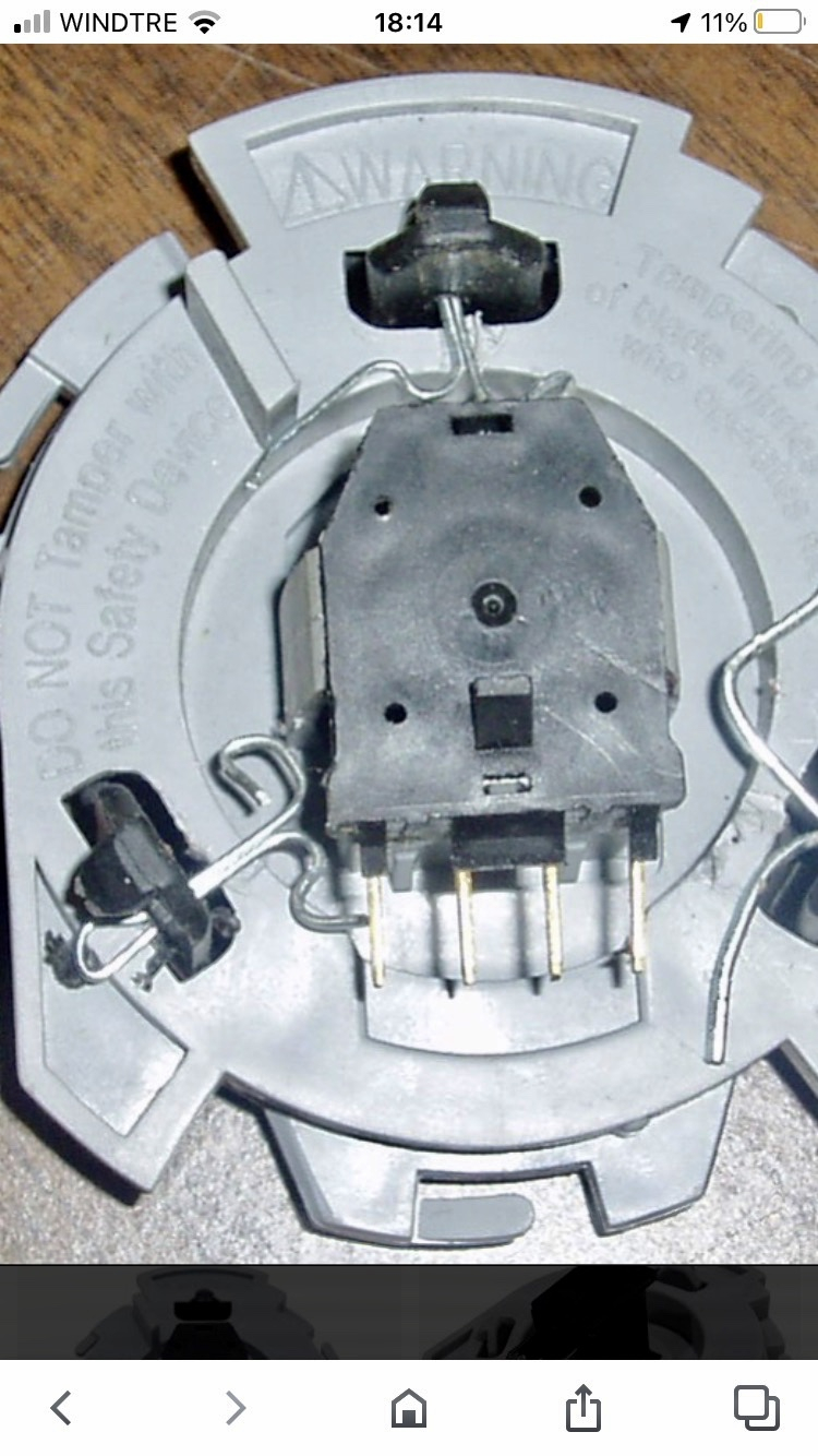

Thanks for the replies. I have taken the seat safety switch off and tested it with a multimeter. Without the seat button being pressed down there is continuity when I touch the prongs at both ends of the switch and also when touching the the two middle prongs. See photo attached. When the seat button is pressed down there is no continuity at all. Does this mean that the seat switch is faulty?

i am not sure if that particular machine uses a normally open or normally closed switch, but my guess its working correctly. most of those switches close contacts when nothing is on it thus grounding out ignition system. when pressed with weight, the system opens and allows ignition system operation..

Remove the kill wire from the engine, and see if it keeps running. That will confirm that it’s an electrical interface issue. You should connect a wire to the ignition terminal on the engine that you can manually ground to stop the engine at the end of the test. Just be aware that this will bybass all safety interlocks and make absolutely sure that you and and anyone else is clear of any moving parts.
