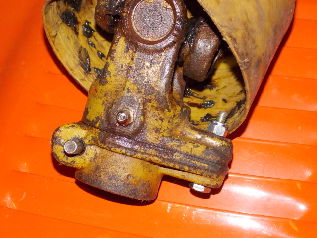

I find it kind of strange and timely that you post this issue with your PTO at this time. While using my rear blower during this past big snow storm, my PTO also shut down abruptly. I thought it was the shear pins; no, shear pins were fine. Then I examined the collar where the PTO attaches to the tractor and found the problem. The PTO shaft became unattached due to a missing bolt that held the collar together. Attached is a pic of the PTO shaft. Note the shinny new bolt to the right. That's the replacement bolt I reinstalled. Luckily I didn't suffer the catastrophe that you experienced. I wonder if you had a similar bolt on your PTO shaft and experienced the same loose bolt.

I think that shinny bolt u put in is a shear bolt and when installing has to be installed with a torque wrench.
   / Help PTO Drive Shaft #5
AStanton - that shiny bolt IS a shear bolt. It is the only thing that holds the two back plates on the U-joint together. I have such a setup on one of my pto driveshafts and it only requires that the bolt be snugged down tight. However, it is important that the bolt used is what the manufacturer recommends for the shear bolt - probably grade 5. If you can not find the manufacturers recommendation I would suggest using a grade 2 bolt. The worse thing that can happen is you will snap a few more bolts than if it were supposed to be a higher grade.
LT - there is something seriously out of adjustment/alignment on your blower. Under such conditions as you explain - it would be normal/usual to have a shear bolt snap or the slip clutch slip. Having a U-joint explode/bent drive shaft is not a normal thing. I would be certain that the dealer not just repair the unit but determine the cause of the problem and address that.

The two matting surfaces at the shear bolt area need to be crisp and clean. If the bolt was loose and surfaces were slightly apart then maybe the shear bolt rolled over slightly and then sheared. If that happened then the next shear bolt will not last as long. See what the dealer says
