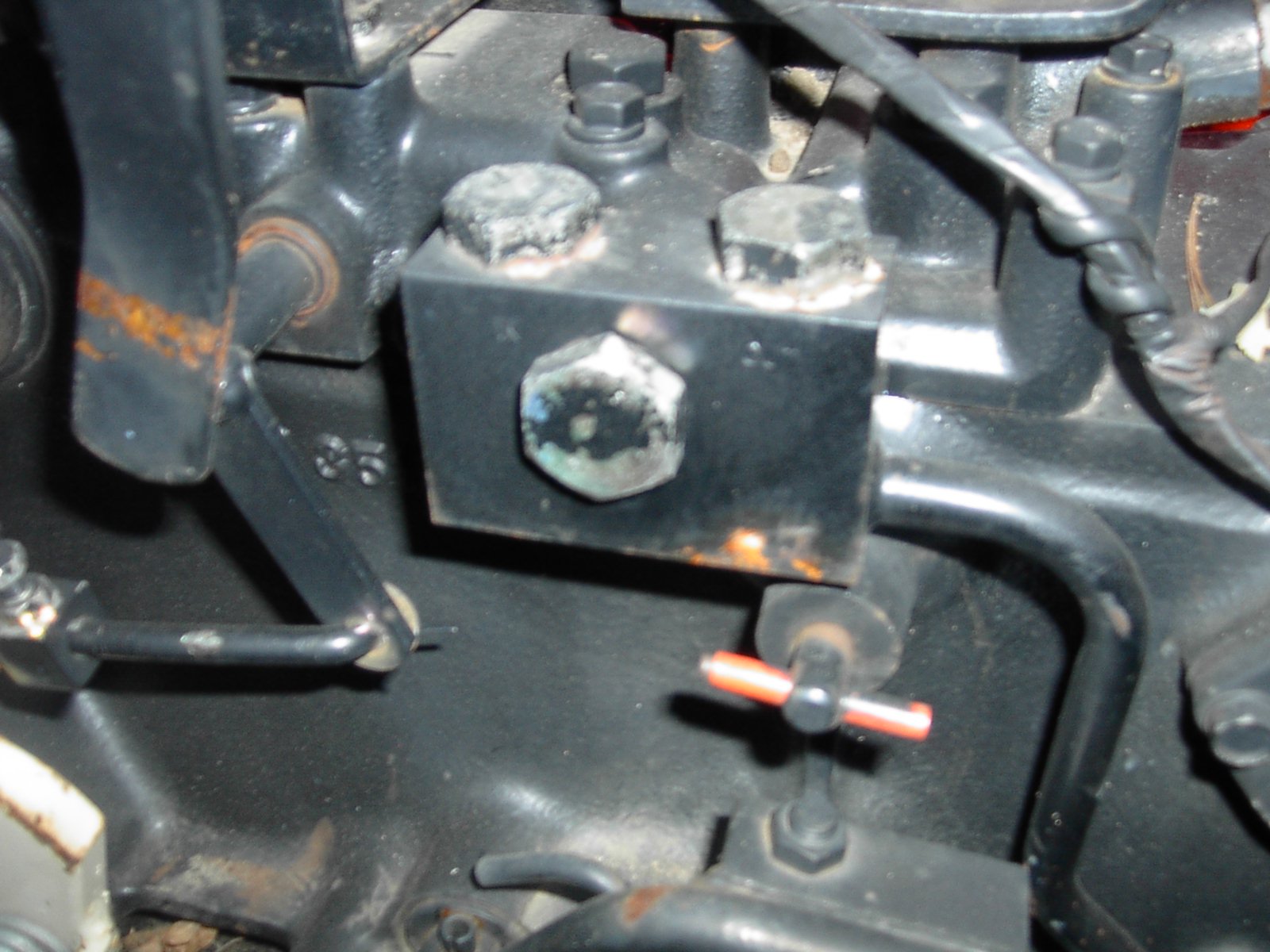

todda, if you look under the right side of your seat, does your hp line go into a block that looks like this ? If so...... i recommend tapping into your hydraulics here.....instead of cutting the line.

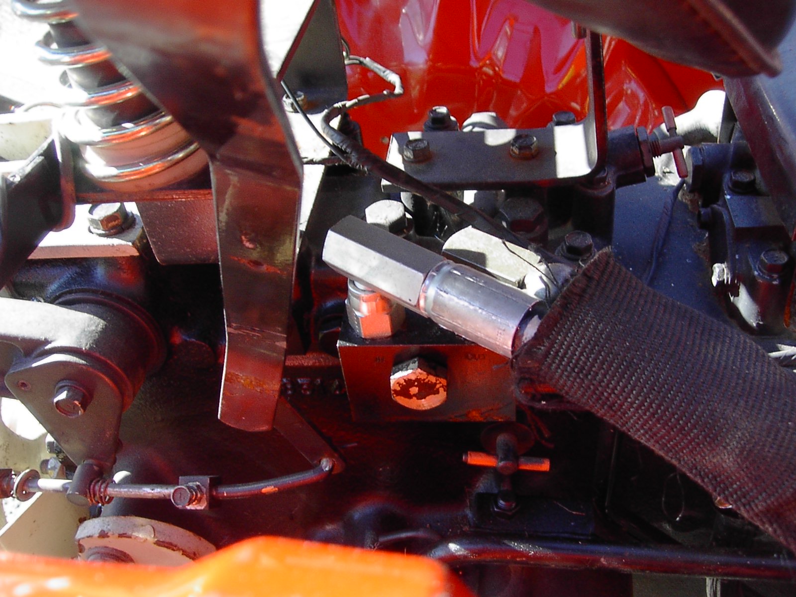

You will end up with two hoses coming out of the block to your aux. valve, and it will look like this.........
