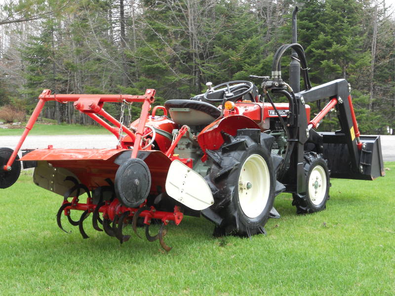

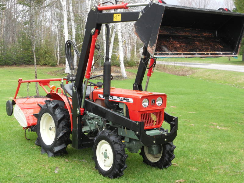

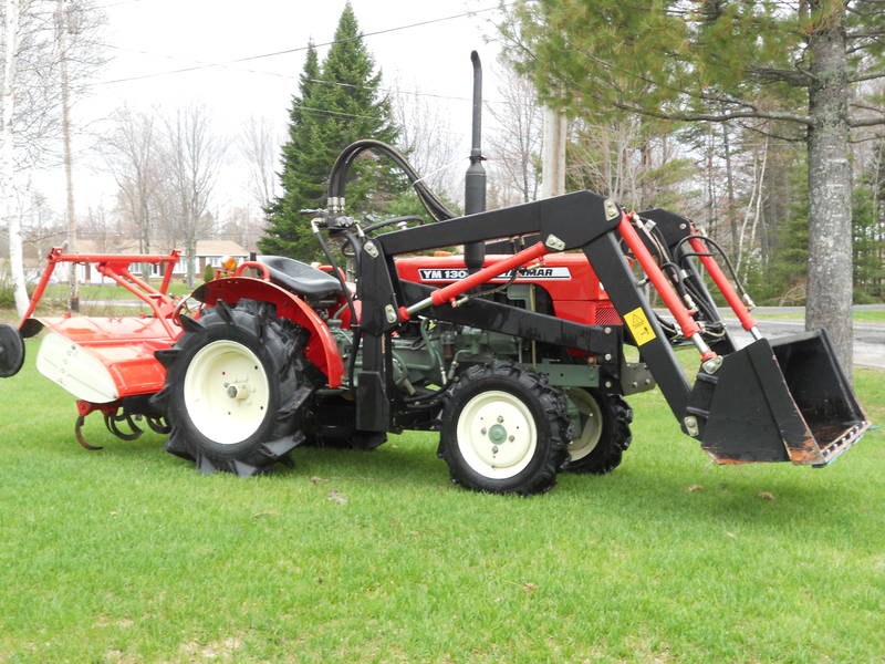

Hi Since two months I have a tractor ym1300D (my first tractor)
If someone can help me please I have 2 questions
1- my fuse box (the old model with wires) I would like to change it but I don't know the amperage of each wire - is there someone who knows this amp? please tell me from left to right for the 4 wires
2- I leave in Quebec Canada; in winter the mercury can drop to -30 Celsius while I can not keep the ratio 40/60 antifreeze/water. If I change it 50/50
could this make damage to some part of the tractor ?
thank you and sorry for my english

des photo
