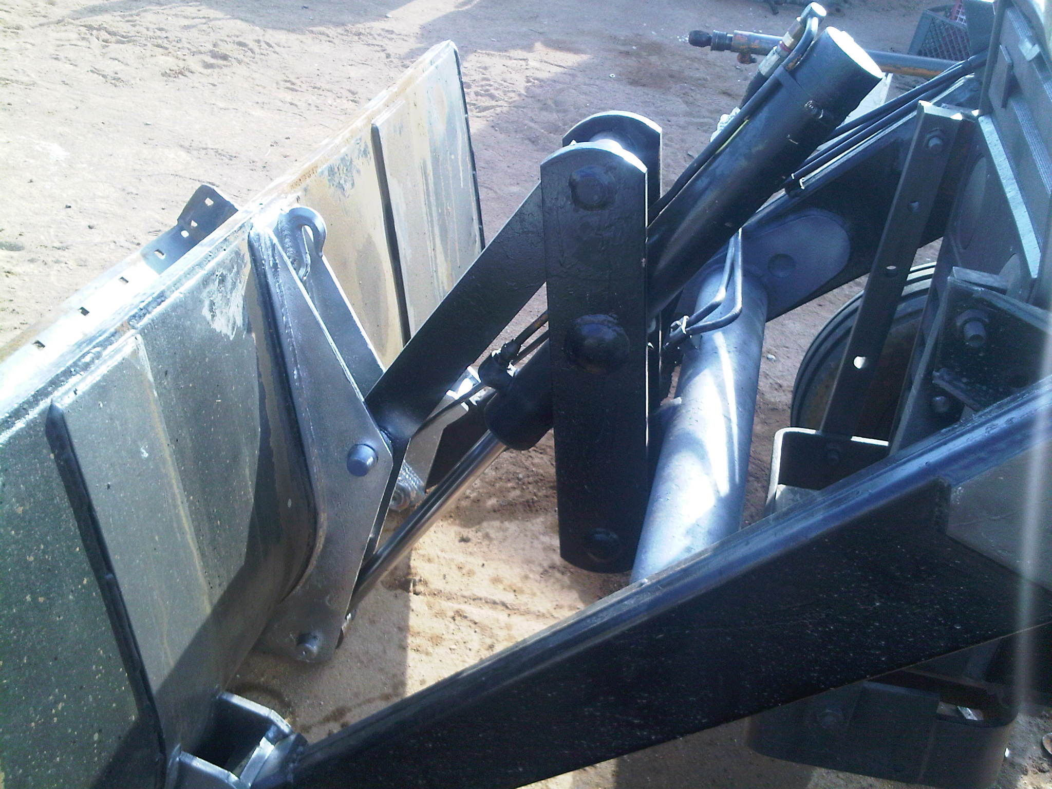

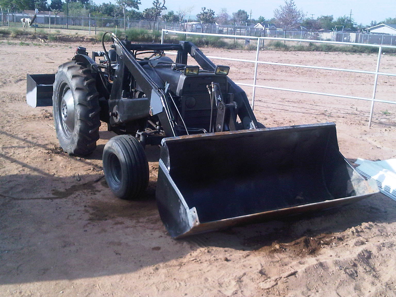

mf240 with a case 480 frame and front bucket that i have no idea what it is

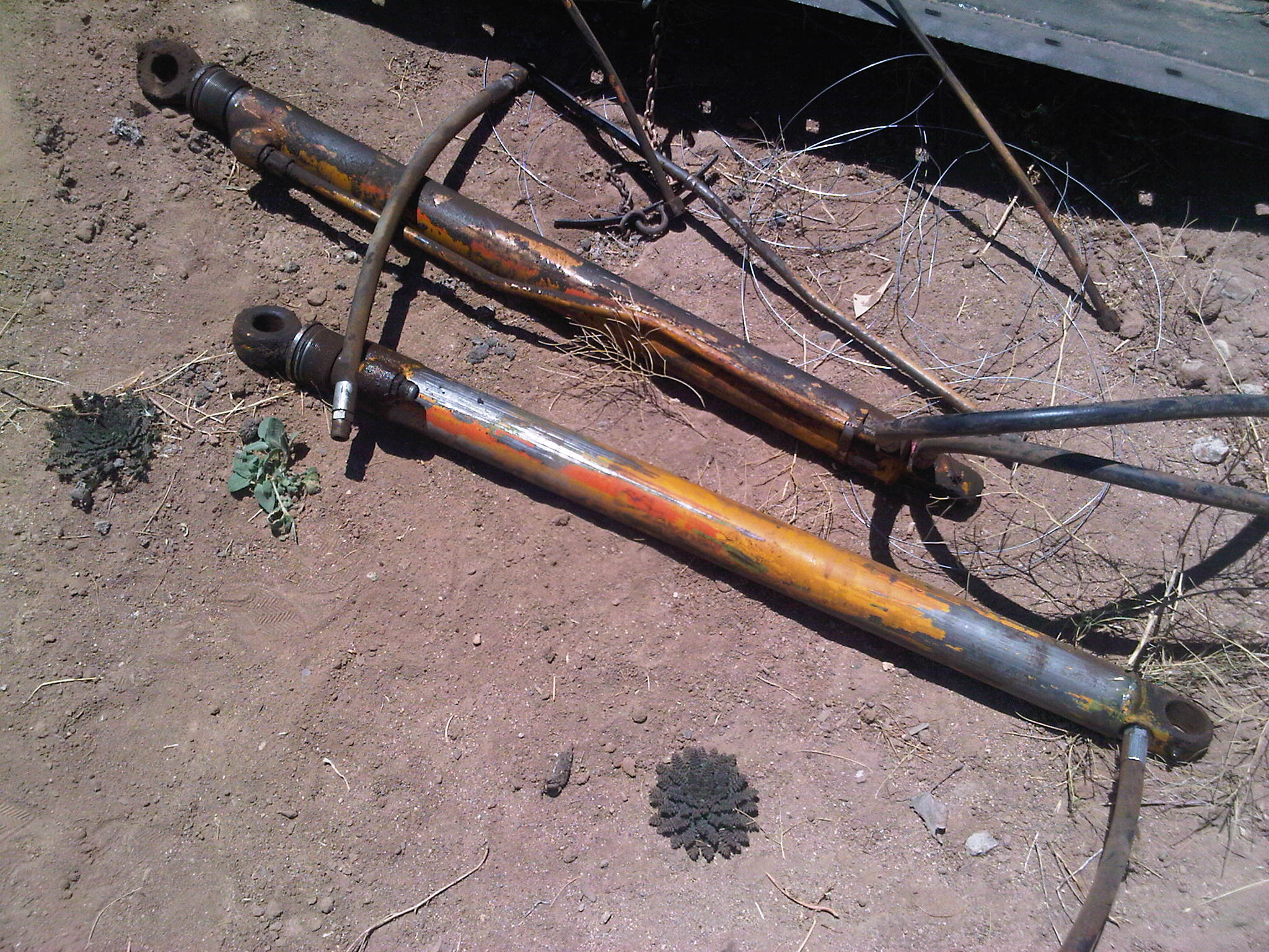

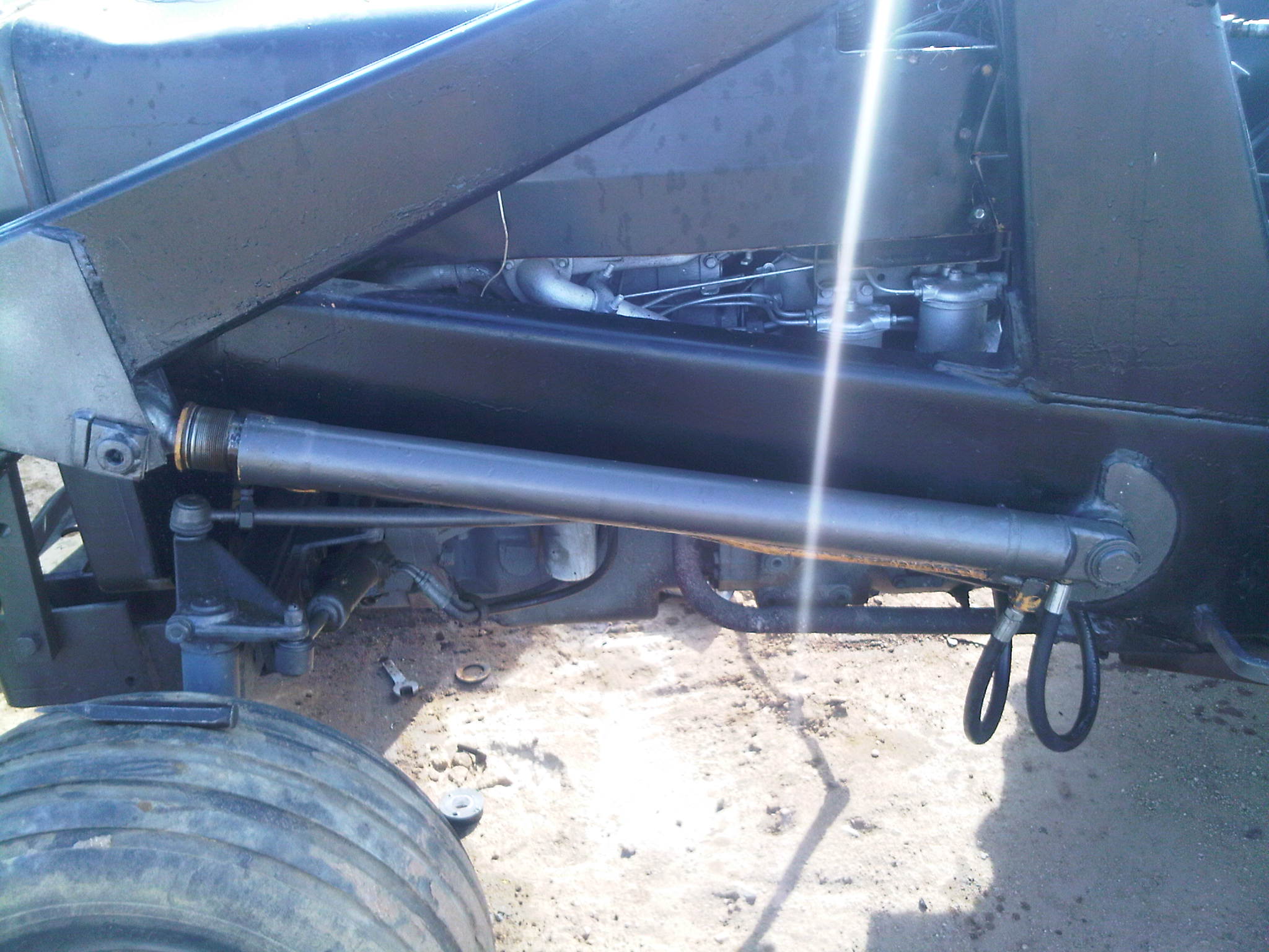

i have an mf 240 on a case 480ck frame. i took off the front loader because the two cylinders were shooting out fluid how can i fix this. i really need to use the loader for my future work on the ranch. i have a gannon and it seems to be working fine for now. please help .

From what I can see, it would appear the cylinders have been setting with the glands unscrewed for some time. Need to take the cylinders off the loader, pull the rods out and clean them out real good. You probably need to take them to your local hydraulic shop and get new seals and o-rings. Once they are spotless inside, put them back together. You might want to let a hydraulic shop do all of this for you if you have no experience. Nice looking rig you have there.

Sounds like u were just bypassing in the cylinders. once u get them fixed u should b ok but like kim said make shure they are good and clean before going back together.

Just a suggestion when working with hydraulic the clearances are tight keep the ends of the fittings covered with some thing and out of the dirt. wrap then with a rag and electrical tape to keep the dirt out.
the packing glands are screwed out of the cylinders in the ground and on the
the one on the left side view.
Dirt = enemy of hydraulics
