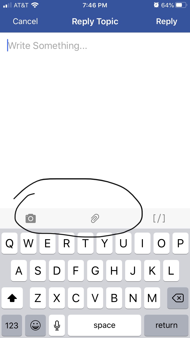

How do you upload a picture?
**I downloaded the app. Now I see the option to upload.

In order to upload a photo at least on a reply such as this is there are 3 spaced out items just above the keyboard. The camera will take you your camera and you can take pictures and load them, or the paperclip looking thing allows you to upload attachments, you should be able to access photos and add them through it. Adjustments.JPG
