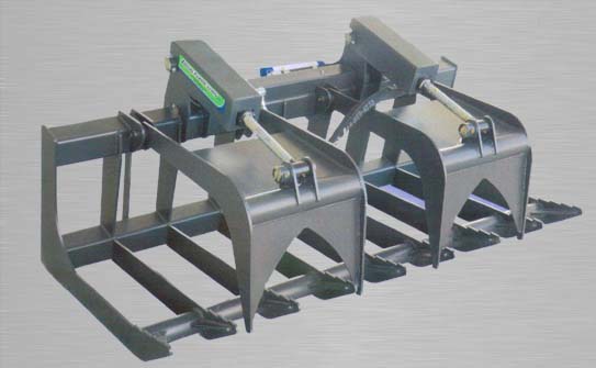

I have a Loflin Monster Grapple:
Have had it over 4 years and haven't hurt it with this over 6,000 pound lift machine. :thumbsup:

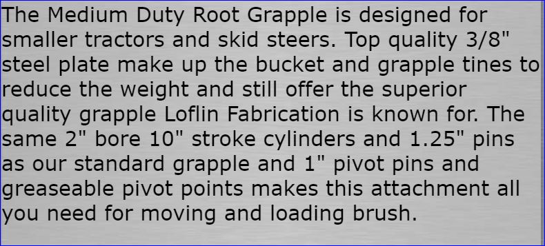

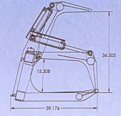

This is their tractor model:
I think you will be happy with it. :thumbsup:
