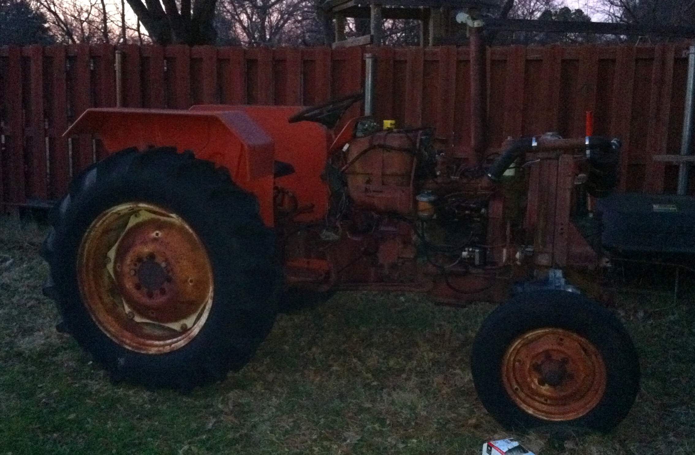

John Deere 50, UTB
I just bought this tractor and it has no sheet metal on it and I can ID the model and need help can any one help out on this...
Here are the clues
UTB/Universal tractor from Romania
3 cylinder diesel
based on the pump identfication it is for a 8035.01.308 Fiat engine
decoding that it is a dry sleeve ag engine naturally asprirated with 95x110mm bore and stroke.
It has a two range transmission with 4 speeds

Universal was the company in Romania that made most of the old Long tractors, I think they sold them in Canada as Universals too. since its not blue it is not a long. thats about all I can offer, others will undoubtedly know more.
   / HELP!!!...Please Help ID this tractor #3
My father owned a Universal 530 and it was blue in colour.
   / HELP!!!...Please Help ID this tractor #5
Check out for the Fiat 540. UTB 650 is 4 Cylinder
   / HELP!!!...Please Help ID this tractor #6
One of my neighbors had a UTB 445. The fenders and color look a lot alike. Good luck finding out more!
   / HELP!!!...Please Help ID this tractor #7
That is an Allis Chalmers 5040 or maybe a 5050. Allis bought tractors in the mid 70's- early 80's in Romania to supply the 40 - 50 hp range. I sold Allis Chalmers back then and do have specs on both models.
